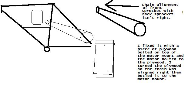

I fixed it. Used a piece of 3/4 inch plywood mounted on top of the
other motor mount and turned slightly to align the chain properly.
