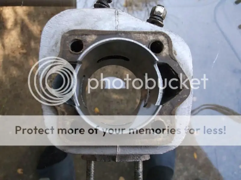

Base gasket on cylinder...lines up well.

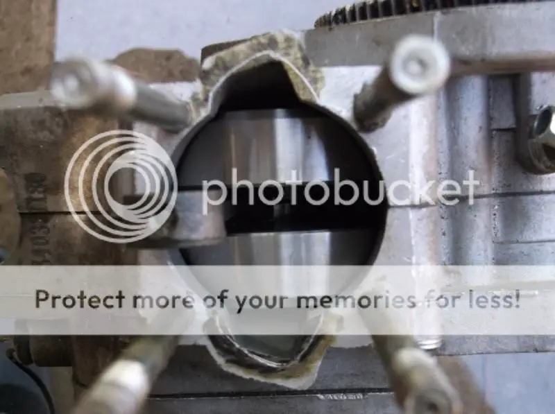

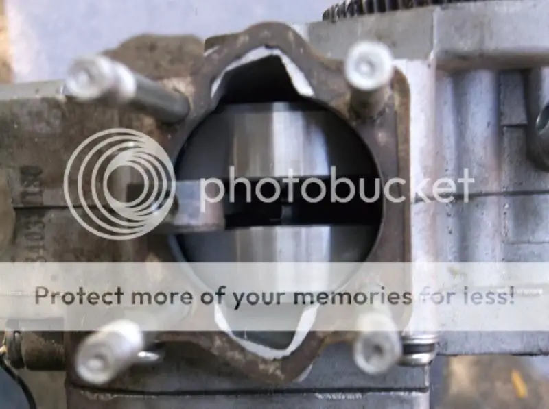

Base gasket on cases...ouch! Not a good match.

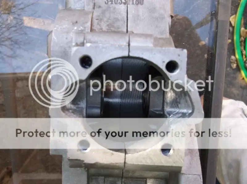

Used a awl to mark around the base gasket.

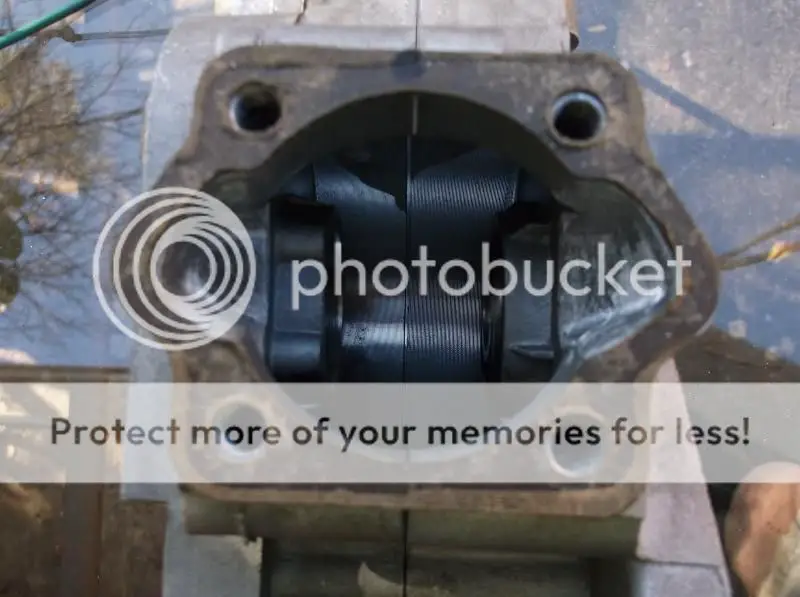

Cases after grinding away up to my scratch lines.

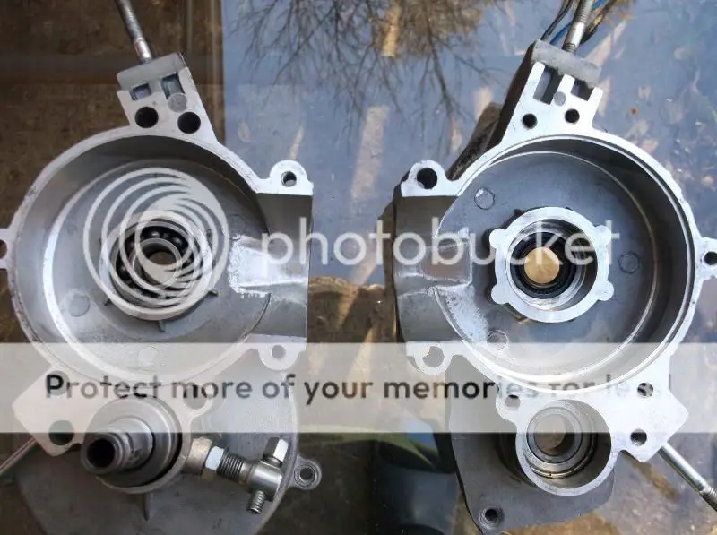

Cases trial fitted back together...Oh, sooo much better!
This motor runs much smoother now, has a very noticeable power increase, accelerates way better and was a lot of fun to do.
