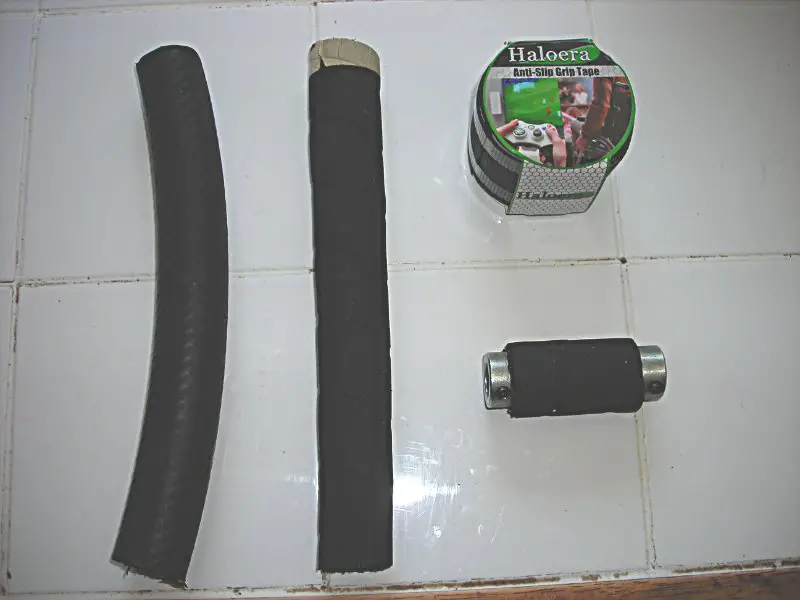

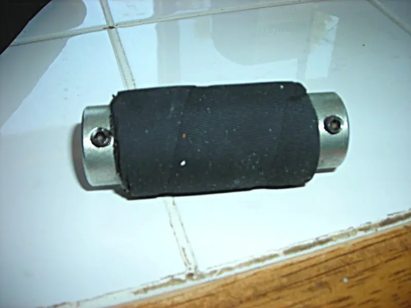

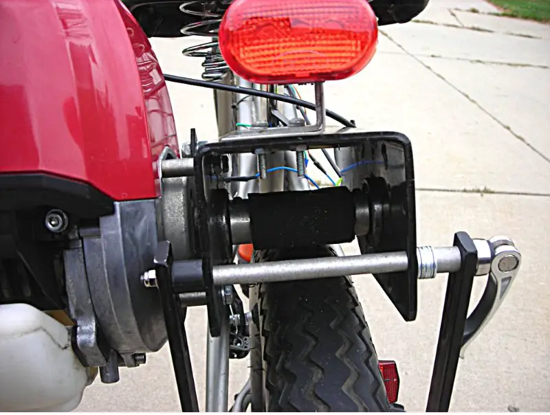

After getting the hoses, I made two roller rubber samples by sliding the hose over the knurled
portion of the steel roller, by pushing the hose with the roller inserted against a sturdy table.
Both were hard to slip on, with the SBR rubber being the most difficult to insert. Then I had to
cut the final length of hose over the roller. I could cut the EPDM rubber with an exacto knife,
but the SBR rubber was so tough, I had to use a dremel with a ceramic cutting disk to cut

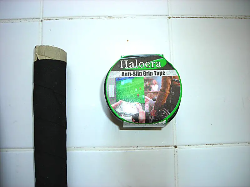

the rubber. Then I discovered that the SBR hose has some type of rubber tape bonded to
it, and the surface was rough, making it perfect to grab the tire. The EPDM surface was
smoother, and could possibly require a non-abrasive rubber grip tape which I bought, but
I decided to test the SBR roller only. The O.D. of both rollers now comes out to about 1.34 inches,
the same as the largest Staton-Inc. roller. Here's some pics:
(The hose on the left is EPDM, and the right, SBR.) Without a 1 inch steel roller, it might be
possible to machine one from a one inch OD knurled bicycle foot peg.)
