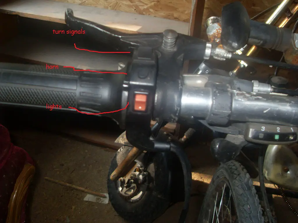

Ok so i have stripped down this 49cc mini motorcycle thing that is nowhere near the fun my bike is. I stole the lights, key ignition, funtion switches, speedo/voltometer/indicator lights, and wiring harness.
I modified the harness and got rid of the electric start circuit. i did leave the 12v regulator attached to the harness, i also have a DIY rectifier from a thread posted here, just not sure if im gonna use the 12v setup of run it 6v.
if i run 12v, im gonna have to find a way to charge without using an external charger. any ideas for this are welcome. (PS the mini motorcycle had electric starts. but it wasnt a starter motor. its a coil mounted on crankshaft with magnets mounted on case, could i make a generator that runs off of the chain??)
Just finished mounting the front lights and guages, as well as function switch (slipped right on) :P
