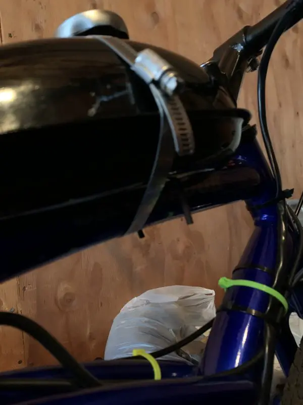

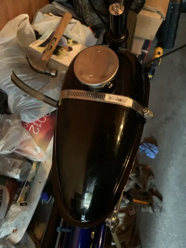

I went to ACE hardware and bought a couple of metal hose clamps and coupled them together as a strap around my tank. It hasn't slipped/rotated since. Below are a top and side view of it on my beach cruiser. the only thing is one side of the strap has execess on it that I will cut off. I figure it should work for most frames and it's adjustable. Now I don't even have the nuts/straps on the tank studs eliminating the potential of the tank stud snapping off and leaking fuel everywhere. Just thought I'd post this up for anyone having same problem. I know there's other posts on this but its just my two cents.

I know. Thats the part I need to cut off with my dremel. It's not going to stay like that. It was getting dark when I did it so didn't have time to cut it off.
