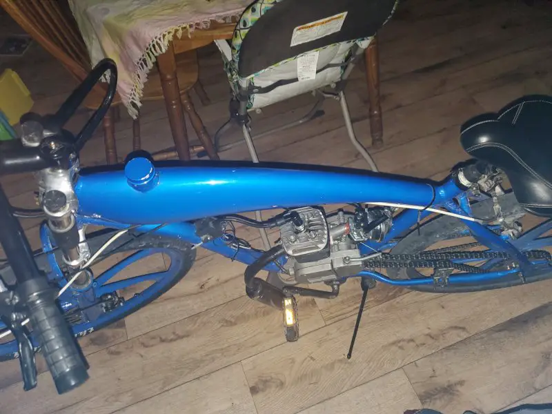

Just broke in my 66cc china girl. It's got a bike berry hp carb and I'm wondering what size jet to get. I dont know if the bigger number the jet the smaller hole or the other way around. Its 4 stroking at 1/2 to WOT and getting wayyyyy to much fuel. The plug is black. Half throttle is faster than WOT right now. I think the stock jet size in the hp carb is .70 and just wondering what size jet I should get. My altitude is around 400ft and average temp is usually around 70-80. People are saying to run a .90 size jet? I dont know if that is a bigger or smaller hole.

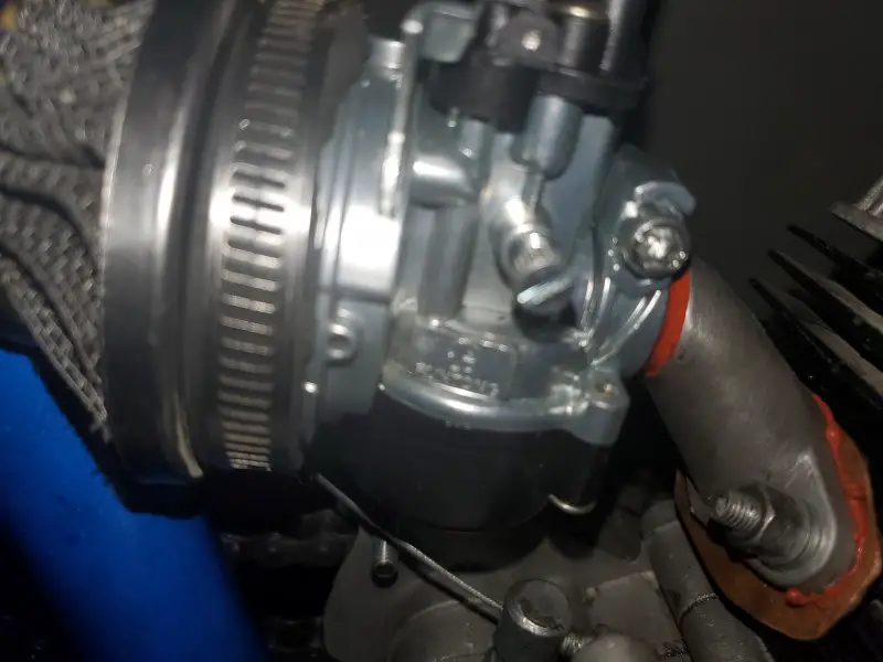

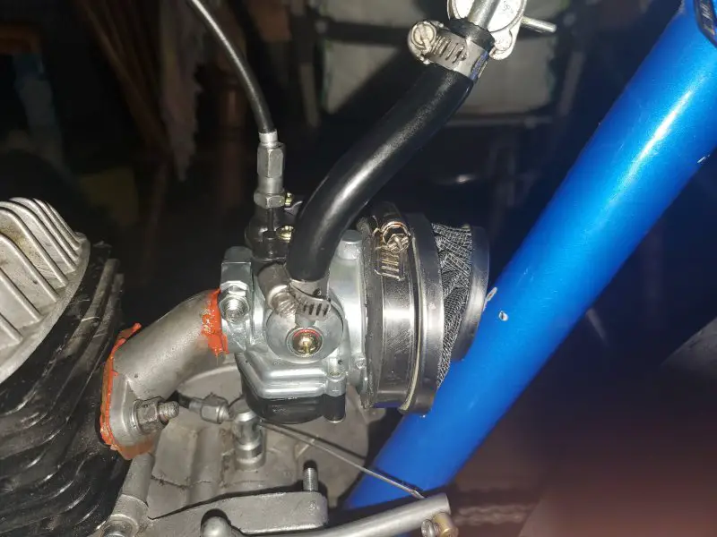

I have the runtong hp carb and I dont have micro bits and I'm wondering the stock size cause I tried the nt jet and was to lean jet that's on it is too rich

My guess is that they are not exactly very accurate. One #70 will sometimes be smaller than another #70. Stock size for both carbs is supposed to be #70. For the HT Carb, most of the time #70 is too rich, and you need to jet down, usually in the 60's.
