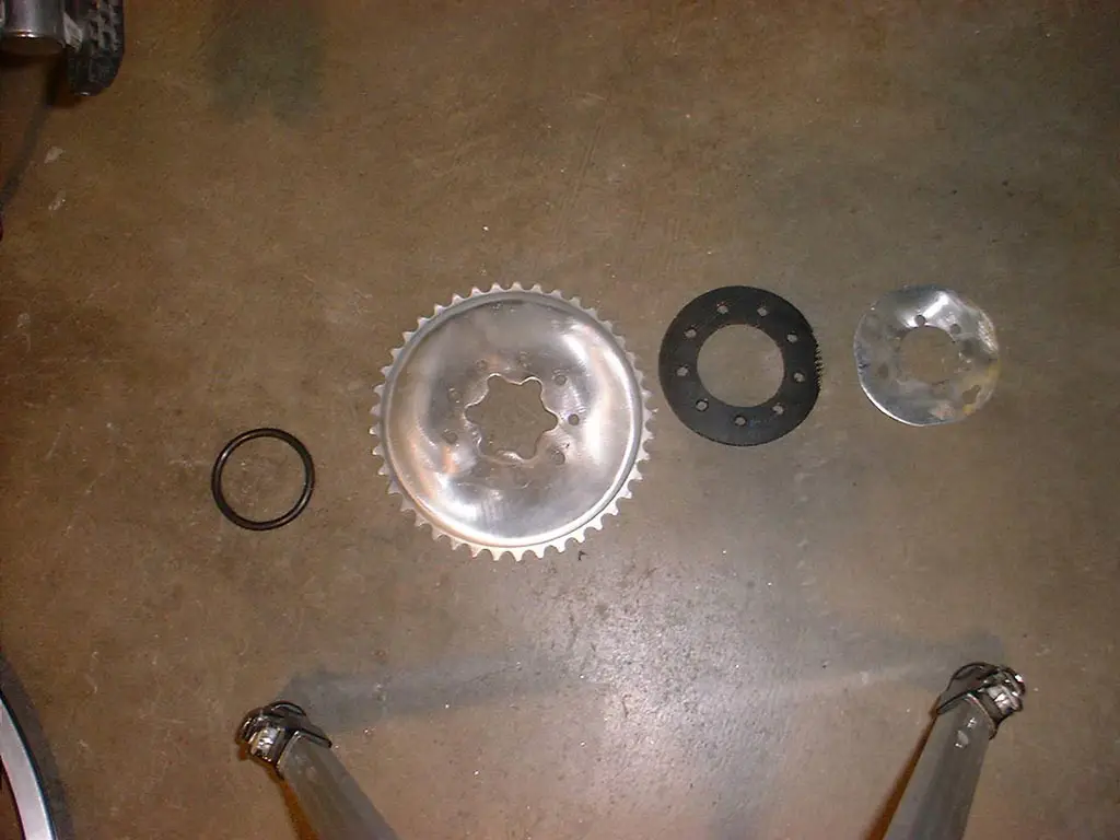

If the sprocket is mounted where the disc brake rotor mounts then that's your problem. The sprocket is too far to the left. Mounting the sprocket to the rotor mounting area can be done but the sprocket should be machined to fit 'over' the hub; not on the outboard edge. A spacer must then be fabricated that will utilize the rotor mounting holes and the sprocket holes. I don't have a very good photo of this but I'll attach one that might explain how to do it.

Actually I bought a 36 gear tooth from a vendor on this site to mount to the disc brake spot but then I had some of it milled out to get closer to the center of the hub. I don't want to mill any more for fear of making it weak. That's why I was asking about shimming the drive sprocket. Can it be done?
Not really. There is very little space to move the sprocket outboard from the original position. The sprocket and the cover are part of the clutch actuating system and there is no space inside the cover to move/shim the sprocket to the left.
I'd like to see a photo of the sprocket you bought and had machined. The rear driven sprocket must be closer to the wheel/spokes to get anywhere near the correct chain alignment required. Offset to the left as I picture your sprocket to be, you're going to have problems.
Please try to post a photo/s of your rear wheel with the sprocket installed as you have it.
I have to wonder why you're opposed to mounting the sprocket with the kit supplied rag joint or one of the available sprocket adapters either of which would allow the chain to be correctly aligned with the engine drive sprocket.
I have a caliper brake on the back tire for stopping and I'm using the disc brake mount to mount the sprocket that I got online. Read that that was a better way to prevent rear sprocket wobble issues. The chain alignment isn't off by much but if the front can't be shimmed then I will work on the disc brake mount. It is thick enough so it can be milled down but it means taking the rear tire all apart. I will send you a pic soon, hopefully it will cover what you wanted to see.

Back to your problem. I see you're using a chain tensioner. A good idea if some misalignment is necessary as it might be with your sprocket mounted outboard from where it should be. Try sighting down the upper chain path from the rear looking forward to the engine drive sprocket. Use a straight edge if possible to check how far off from center your chain is. Something like 1/4 to a maximum of 3/8" is tolerable. The tensioner will help guide the chain onto the rear sprocket. Anything exceeding 3/8" off from center and you need to do what is necessary to reduce it.
I hope all this helped and didn't confuse the issue.
By the way, have you by any chance contacted the seller of that sprocket to ask for advice? He might have a trick or two he could offer. I'd very very cautious about milling down the rotor mount area. One thing to keep in mind is that doing so will reduce the depth of the mounting fastener holes. That brings to mind another issue with this setup. You'll be driving the rear wheel with only six, 6mm screws. They'll need to be quality fasteners and kept tight. That's a lot of stress on those little fasteners.
