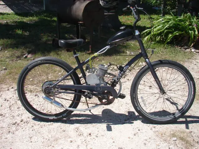

Its my friends bike and it started making some noise down low....He kept riding and it finally locked up...

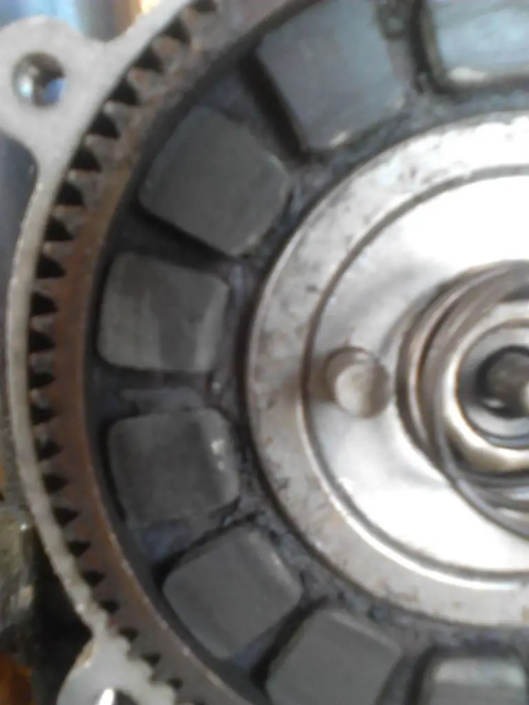

Clutch looks like pics.. Is it toast???
Can I just replace pads????

The clutch pads look like they have a greasy coating. Possibly from over lubrication of the gears or a leaking crankcase seal behind the primary gear, right side. You could try cleaning the friction pads using brake cleaner (wear eye protection) and drying with compressed air.

yeah, clutch pads look almost new - they appear to be the better of the 2 choices in pads, but could use some cleaning/trimming
