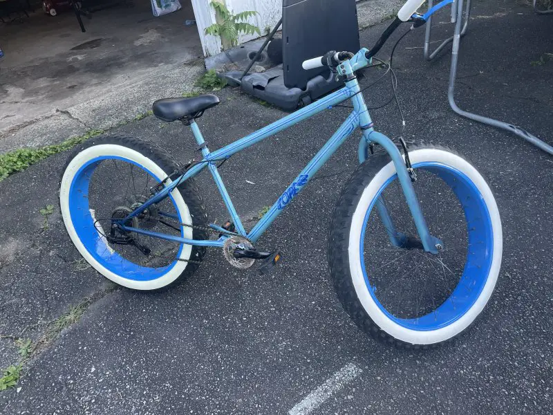

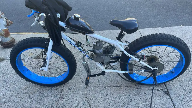

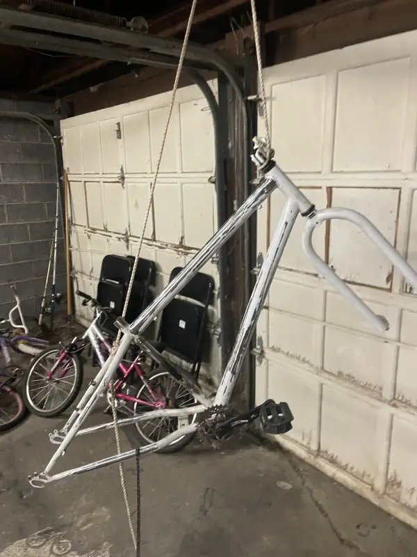

Just got first motorized bike, already assembled by someone else and im the third owner since the kit was installed (Seeutek Pk80 clone kit)
tbh i havent even started it yet lol but because I wanted to do some mods to make it reliable and also to not make it look like heap of junk that it looked like before i modded it, was gonna finish putting the engine in today but the garage/workshop was needed so its gonna have to wait, probably for the better that way I wait until the head and pull start come in, Why the pull start you may ask? glad you didnt ask, because im too broke to buy a jackshaft kit so im gonna weld the sprocket to the left side of the pedal jackshaft (yes ill have to remove the pedals, ill weld some pegs somewhere tho) and that way I can use the gears, i wont be able to start it using motion so hence the pull start, I also need to come up with a way to mount the engine without damaging the paint

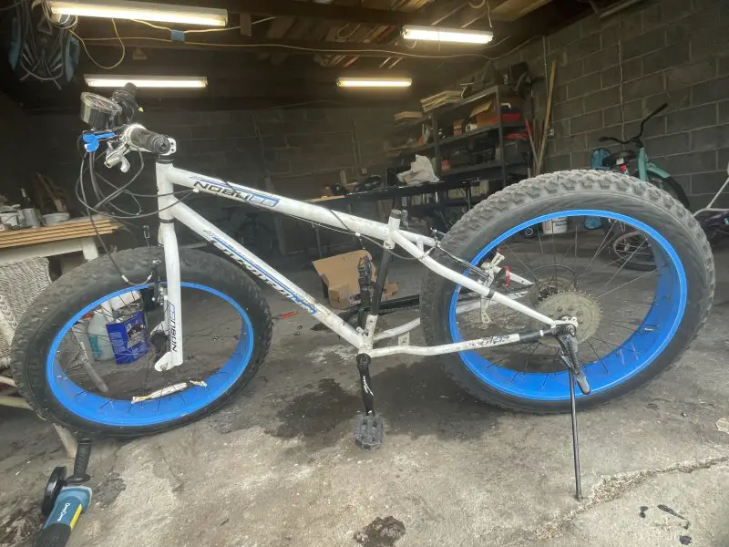

You can kind of see that the tube of the frame that houses the seat tube is black unlike the rest of the frame which is white, this is because I had to weld it since the previous owner, for reasons known only to himself (and maybe not even that), decided to cut it and install the black tube except it was just loose, hanged there by the seat tube and inside the bottom part of the tube that he left.

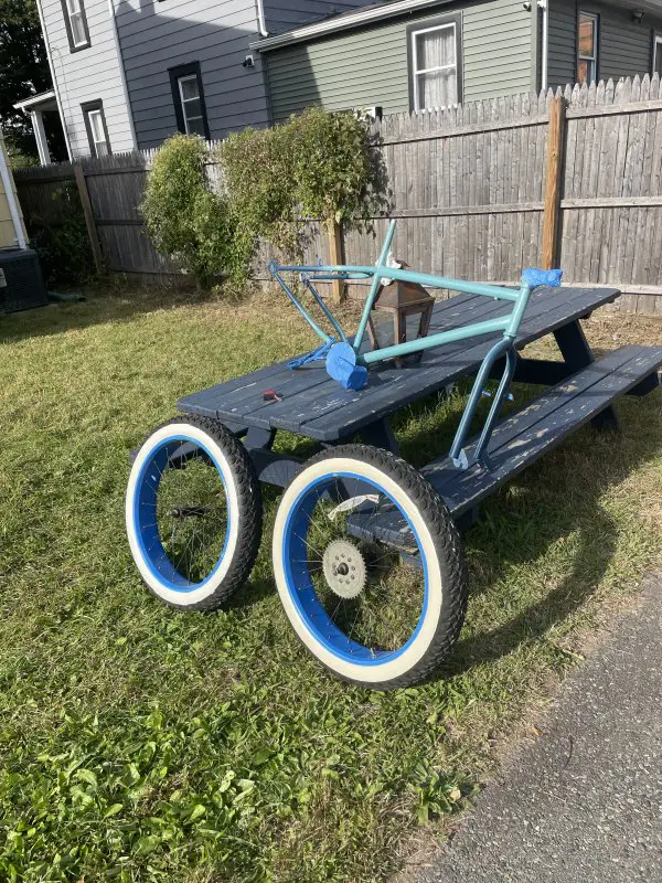

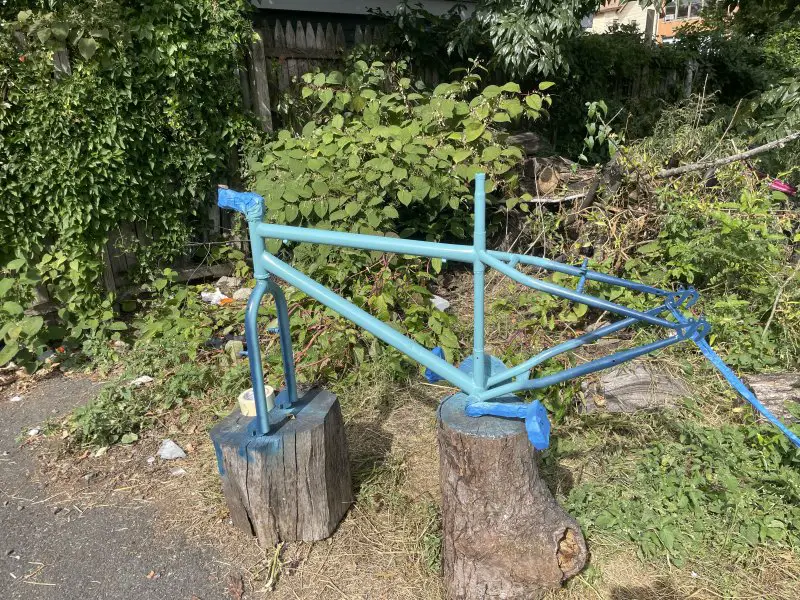

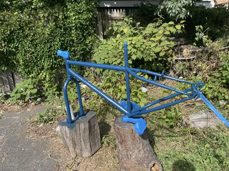

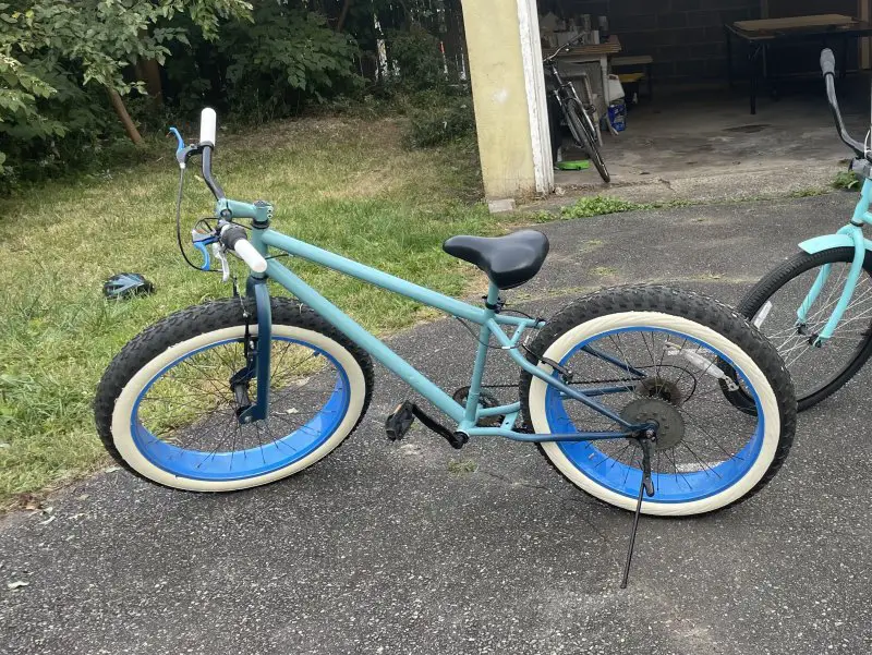

Was gonna leave the blue but ran out and despite what it looks like it still needed another coat so i grabbed the green thinking it would look closer to blue but once it dried i realized it was indeed not blue, however i tried to make it work by fading it in the back and leaving the front of the front forks blue kind of like a fish which is one color on the top and then fades to another on the bottom, looks better in person i swear, I also want to do a pattern on main triangle and the seat tube I just dont know what to do, Ill do my last name on a cool font in the bottom tube and im thinking of doing those cartoon lines with sharpie that people do kind of like this,

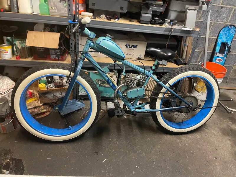

Finished the paintjob with some comic/cartoon style lines and a graffiti style name on the side, initially i was gonna leave it like this untill the jackshaft kit came in but im too eager to ride so I decided to just put the engine in and ill put the jackshaft kit some other day
Still havent fired it up because im waiting till the 3d printed throttle finishes printing and then i have class so I wont have time, safe to say I wont be focused during class
update; tried to turn the engine to lube it up before actually starting up and tensioner wheel exited the building,
so now i gotta print that and ill probably turn it round since its leaning towards the wheels and i don't want it getting caught in the spokes,
also Ill be removing the rubber mount bushings because the engine has some play side to side when the chain is in tension.
And lastly the throttle has to be reprinted since I didnt realize I modeled a mirrored version, hopefully I can start it today, probably not tho, things never go as planned in this kind of hobby lol
