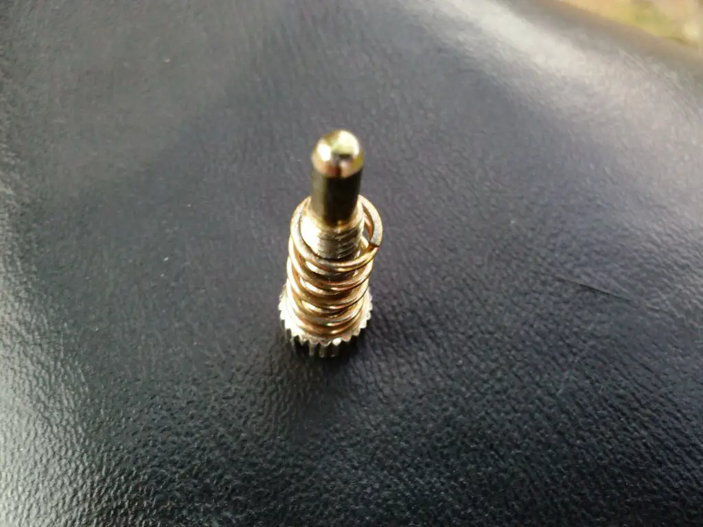

Let us know what you find. The idle speed screw has a pin at the end, or should have. It is smaller in diameter than the threaded portion. That pin is what engages the slot, or ramp in the barrel that allows idle speed adjustment.
Possibly it is the wrong screw or the pin was broken off.
Can you post a photo of your carburetor and the speed screw out of the carb?
Here are the pics you asked me to post. I dont see a smaller needle on the end or even a place for one

everything looks fine to me...
EDIT: lots of the engines ive bought recently have come with loose intakes due to crappy acorn nuts on the intake bolts. Try removing intake, making new gasket and replacing acorn nuts with lock nuts or even better allen bolts. Good luck! MOTO
I found my problem. I went and unscrewed my throttle cable from the carb and pulled out the Barral for some reason it wasnt lining up right. I fiddled with it and slid it back in and it went further down in. screwed it back together and Viola idel adjustment works thanks for all the help this forum rocks
nice! I had a feeling the slide wasn't lining up with the little brass guiding thing and was going to suggest that next.
