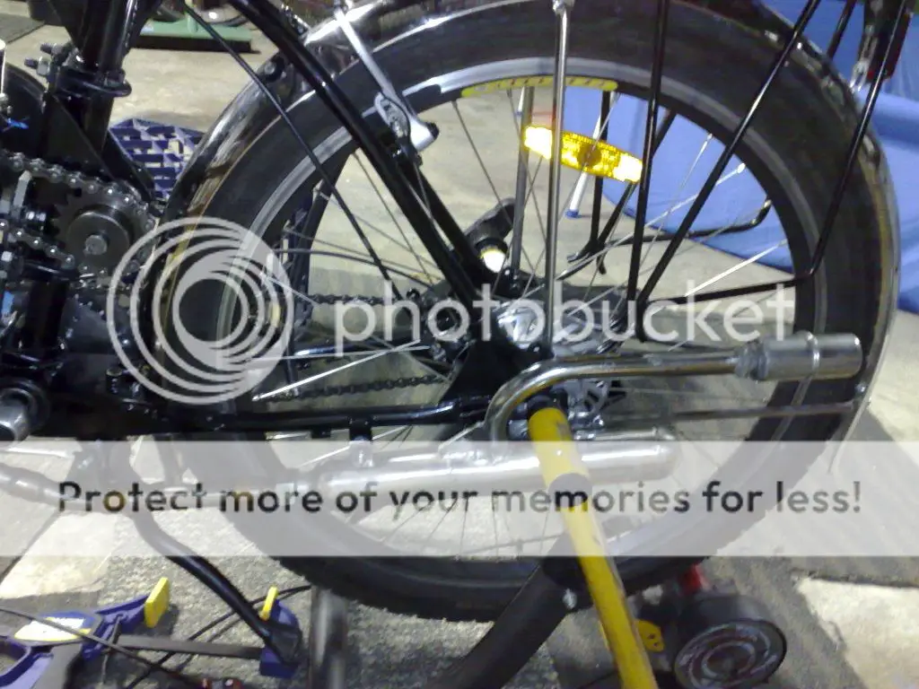

after doing some internet searchers, consensus seems to indicate a smaller ID than the header pipe.
does anyone have any idea's on what sort of ratio of the stinger pipe should be compared to the header pipe?
Im thinking of between a 1/4 and 1/2inch ID.
I have recently doubled the size of the expansion chamber and moved the stinger pipe to half way point of the ex chamber. this is an old pic of the exhaust pipe. but the header length is still the same.
engine: 48cc, 2 Stroke.
exhaust: 1inch ID, and long. see pic.
any suggestions?
