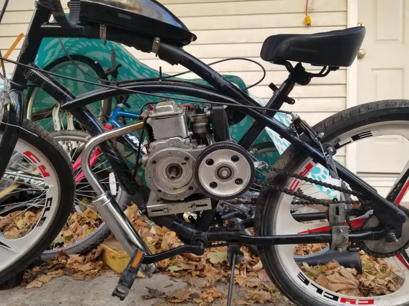

Huasheng 49cc 5/8 straight shaft
TYKSTER2020
Before I purchase a whole new engine I figured i'd ask around. Where can i find a transmission for this engine? I've looked everywhere even ordered wrong parts that i had to return. Im at my last month of searching for the transmission... Help me please... I asked the Lord but i think he guided me here...God Bless
I'd suggest getting the 4G transmission and doing the modifications to make it work. There's several routes you could go to do this.
You better look again, it will not fit straight shaft...........Curt
  • Like
Reactions: EZL
Have you looked at Staton inc. for a solution?
will look into this possibility.. i'd hate to give up on this engine.. it has taking me for so many nice rides

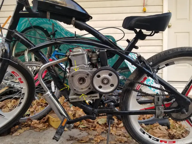

im also guessing the modification would have to be where the clutch bell goes problem is i already have the plate that the clutch and pulley are assembled onto..plate meaning the part the yellow arrows point to.

hmmmm i'd have to have a video... i've looked all over for transmission modifications and only found one guy who was welding...i truly appreciate u guys input..
Options would be to have the straight shaft tapered.
Switch out the straight shaft for a tapered one.
Or use a flat bottom drill bit in a press to convert the tapered fitting in the transmission to a straight fitting.
