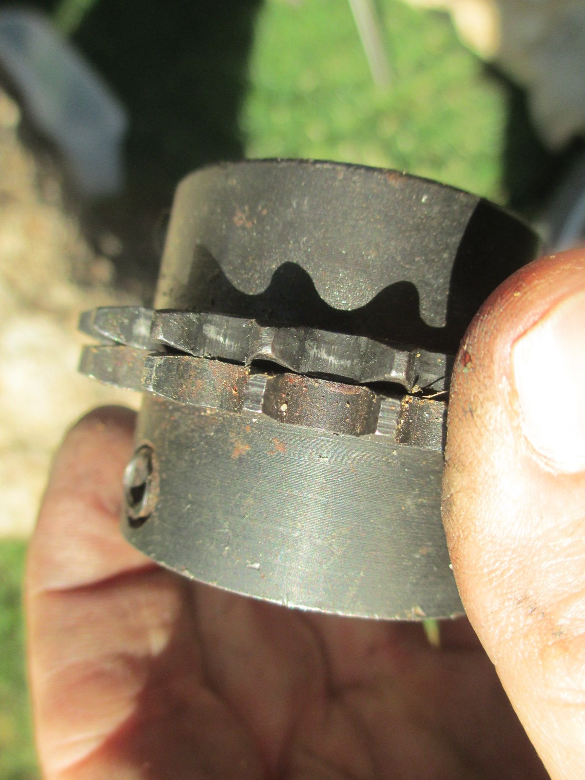

I have a couple of sprockets that have sort of a squared off rather than more pointed ends and they are all for #35 chain.

PS the first picture of the two sprockets held adjacent to one another and that are of the exact same number of teeth, are just to show how same number of teeth and both #35 type can look different, the shape of the teeth.
