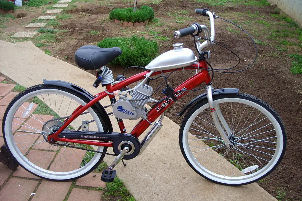

Alot of bikes don't have enough space in the frame to mount these engines.Did the make a different tube for the carb or can it just be turned to the side. If it can be turned it will allow us to mount these motors on bikes that are laying around everywhare. thanks
Oh yes it can be done. You will have to make a new intake manifold with the angle you need to clear the seat tube. Very simple to do if you have a mig or tig welder, a little more challenging if you dont.
