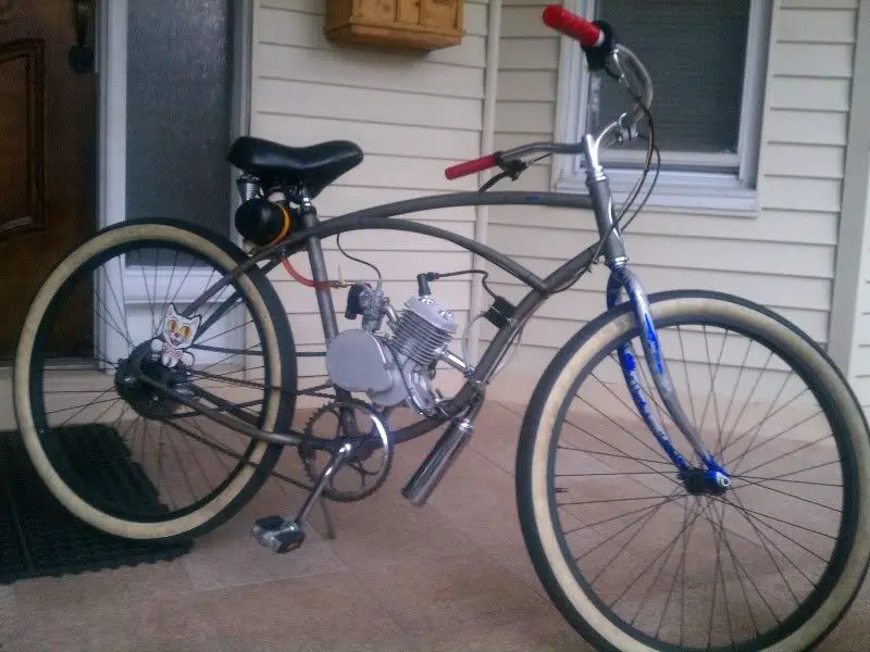

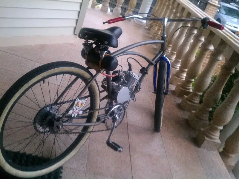

After sweat blood and tears shes complete.
Thanks to the people on the forum who helped me out with answering my questions by giving advise and suggestions.
Paint? maybe later. Some flat black to stealth it out a little.
I like the old worn and rusty look in things, so well see.
The bike is running great. I m breaking it in.
The tank I got off ebay.
Manic Mechanic hub adapter with the 40T sprocket.
I decided to ditch the chain tensioner after all the horror stories I read about. I ran a half link on the pedal side to help with the slack. I do pedal with it so as both chains strech Ill just pull the wheel further back.
loctite on the bolts that can come loose.
got the grips off ebay.
bike was originally blue but i stripped the paint with airplane remover.
Ill post more pics of the build.
