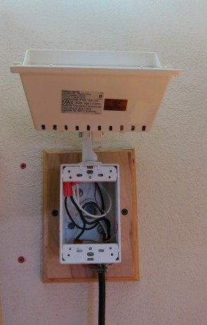

I used to illuminate the living room with a 300 watt halogen outdoor fixture pointed up at the ceiling. Worked great, nice even bounce lighting. And I have a home theater system in there too, so it has to be dimmable.

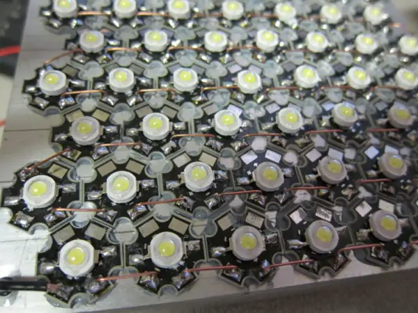

But it uses 300 watts and the lamps don't last long. So I wired (56) 3 watt leds in series on a heavy sink with thermally conductive silicone adhesive.

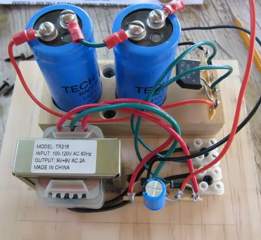

Needed 2 power supplies, a high volt for the array and a low volt for the fan.
