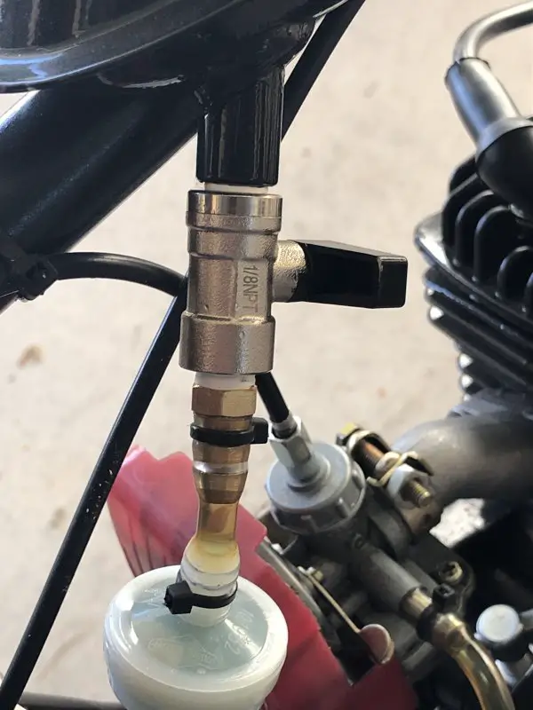

Ace hardware has the fiber washer if you want one. But the real solution is to tap it to 1/8 pipe and put a ball valve from Granger in it.
