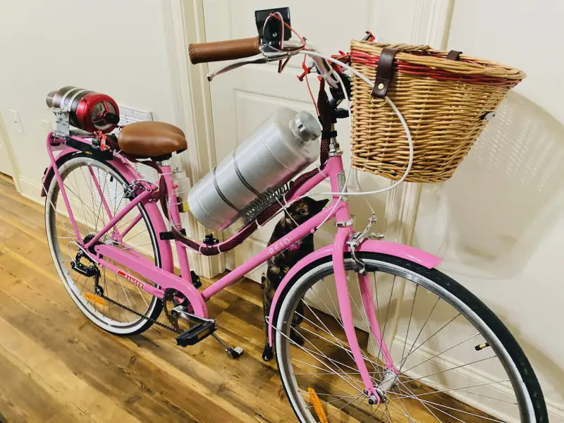

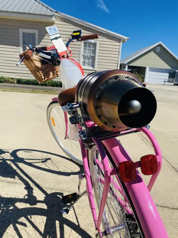

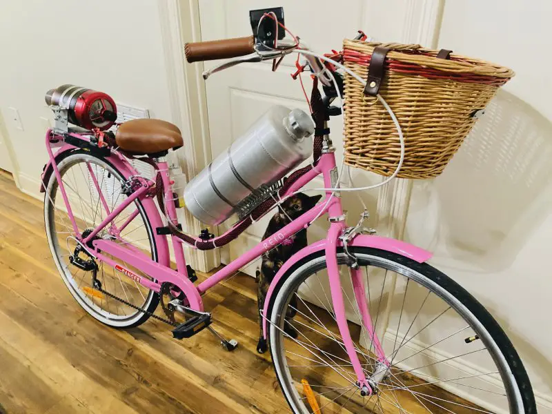

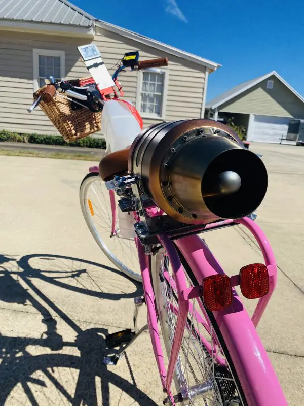

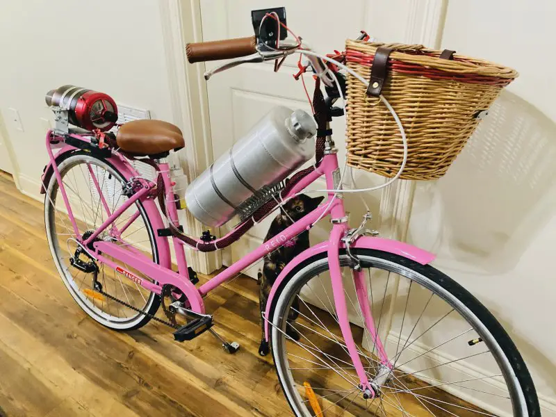

I purchased a pink Reid Ladies Classic 7-speed bicycle recently and installed a large (70lb thrust) micro-turbojet engine on the rear cargo rack as sort of a complex joke. (Note: If you knew my sense of humor, hobbies, and background, all of this would make complete sense) It actually turned out really well, but is definitely overpowered.
Now, admittedly, I don't know much about bicycles, so I'm hoping someone can help me out with upgrading the wheels/brakes/tires.
I'm considering a solid tire wheelset by Tannus or a similar manufacturer to mitigate the risk of a blowout and to accommodate my weight as well as the weight of the all the equipment/fuel.
1.) Will a slightly wide tire be of any benefit (such as 700x40c versus the current 700x32c)
2.) Given my bicycle has a Shimano Tourney 7-speed gear system, can I fit disc brakes (which I assume would be the most robust braking option available) and if so, can you provide any recommendations for a conversion kit?
3.) I can't seem to find any specific size information regarding the hubs/forks/rims on my bike, what other wheels/tires will fit, etc, even in manuals downloaded from Reid--do most cruiser bikes in this category have some kind of standard-sized hub/rim?
I do realize the main limiting factor is that this is a budget cruiser bike, but I do think it can be made a little safer.
Again, I know these are probably very rookie questions, but I really, really appreciate any input.
Anyway, it is VERY EVIDENT that the current wheels/rims/brakes are not cut out for this--so I figured reaching out to some motorized bike enthusiasts might be the way to go.
