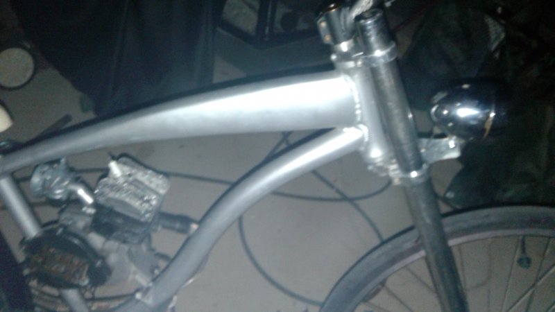

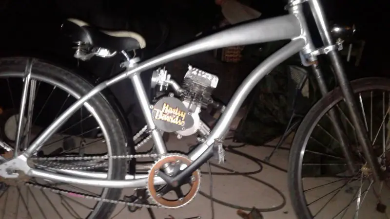

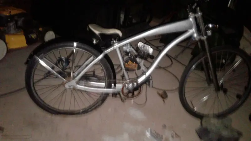

Got this from a friend. Super light and very long compared to my last ride.

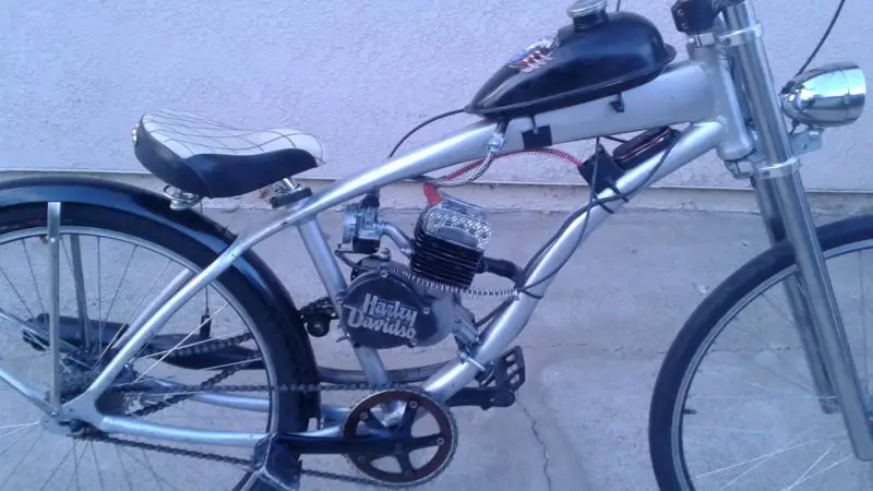

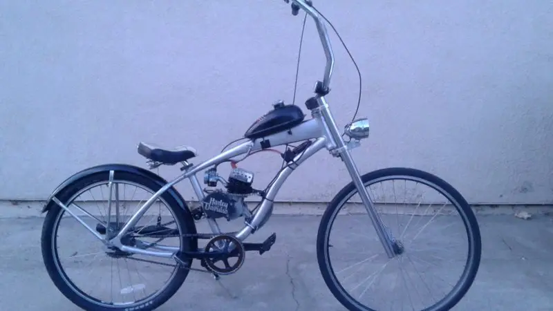

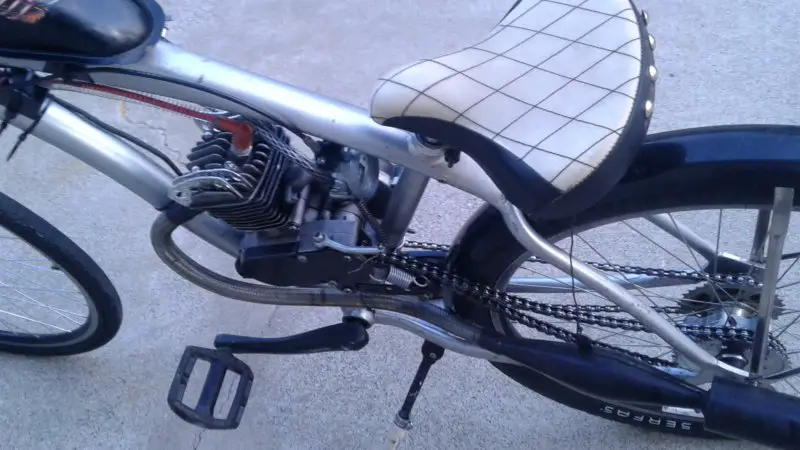

Thanks Jerry! Ultimately I want to put the gas tank in the frame like the ones they sell at bikeberry but I'm running into a few logistical problems. I think I'm going to resort to using an coolant overflow tank for the gas tank for now.
I would get the bungs and fittings and make the top tube a tank... Radiator shop weld in the holes in the seat tube and steer tube if it has any...
The problem that I have run into is the motor mount that I have to use is too high profile and I have to drop it down and shave the back mount. The spot where I would place the petcock is lower than where the inlet for the carburetor is located. But I considered that seriously.
This is what I ended up with
