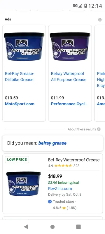

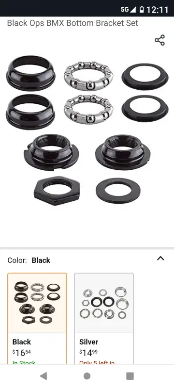

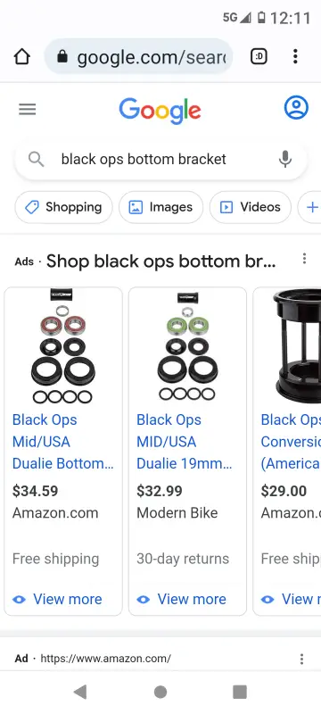

Standing on the pedals riding and the constant vibration is what kills the bearings...

OK thanks I’ll try some new bearings in it to see if that helps as soon as I get them and put them in. I’ll let you guys know if it fixed it.
