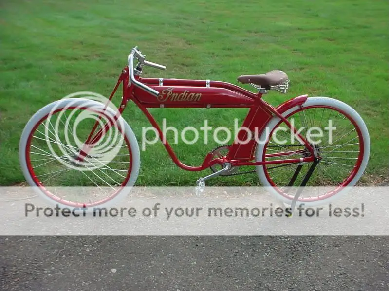

You may want to revisit your Welder friend after you have the engine, so he can weld in a rear 4" to 5" piece of steel tube for your rear engine mount, see attached photo of Tribute Indian with same piece of steel tube for rear engine mount.

Here's Rick's Tribute Indian without the 2-stroke mounted, you can see the steel 4"-5" tube for mounting your engine sticking up:
