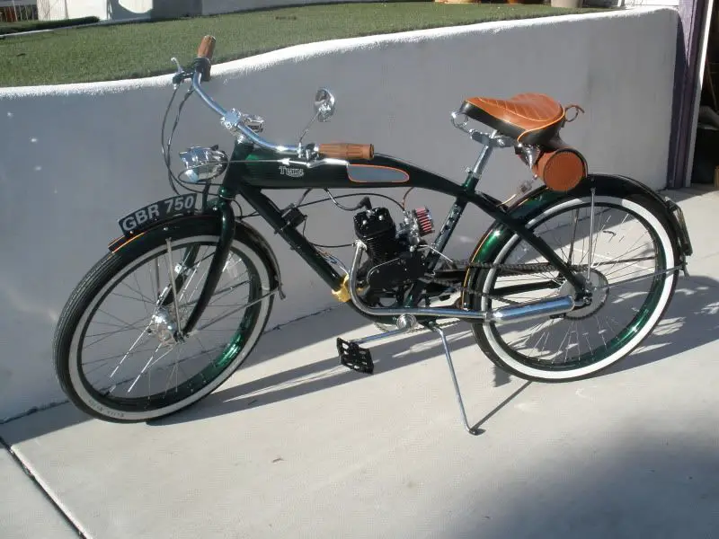

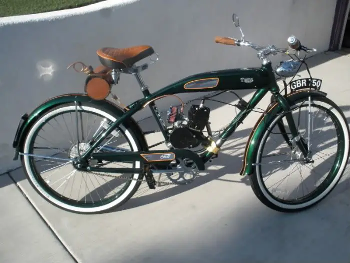

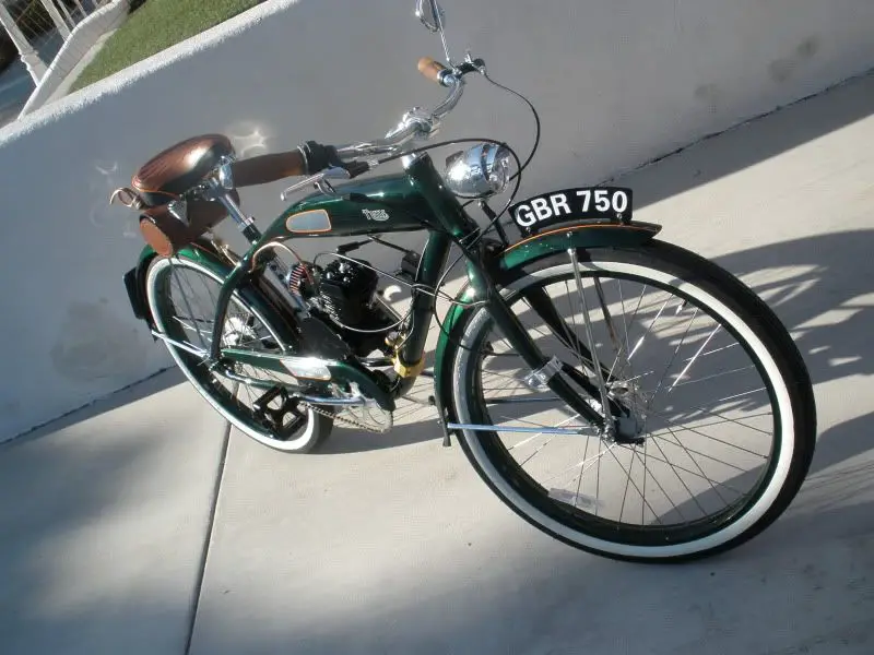

This is my first start to finish build. I learned a lot including how a whole bunch of parts are not compatible.
I started with the Felt Twin and then purchased a PK-80. Standard mounts down work so I splurged on the Ridley mounts. I was hoping for an easy build for my first. I went with the Ridley over the Ampt since I was told they did not work with the PK engines. Turns out the rear mount on the Ridleys doesn't work with the PK either. I ended up swapping out the motors with another I had picked up.
The rear mount fit but the chain caught on the edge of the mount. Some grinding, more grinding, a bit more grinding and my $200 engine mounts finally worked. :-{
Anyway, after a bunch of diversions and hiccups it is finally done.

Excellent build. What kind of tank did use on the rear mount?

I made the tank out of 3" pipe and stuck it in a cheap roll bag after sealing it. I wanted to find a nice leather roll, but they seem to only exist in black leather or at stratospheric prices. The cap is just a brass end cap I found in the plumbing isle. I drilled it and made the pig tale with copper tubing to work as a vent.

Thats a great idea for a tank! My Huffy Panama Jack beach cruiser came with a nice leather roll satchel looks much better than the stock tank from a kit. If I cant modify my tank to fit hidden under the rear luggage rack I'll give your method a shot. Maybe not using PVC however.
