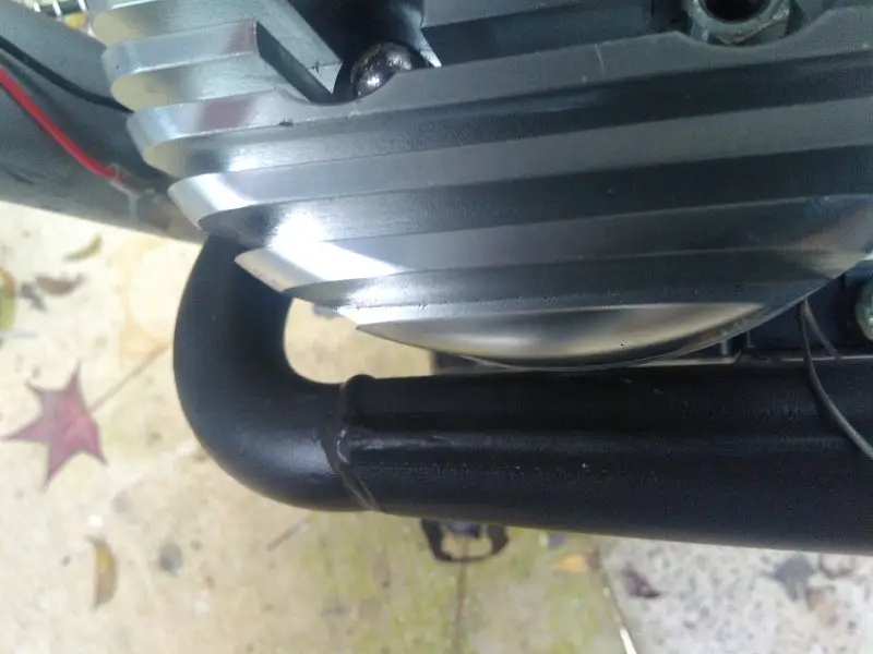

The pipe is good BUT... I'm not so sure it would be a wise investment for somebody that doesn't have a welder or isn't good at fabricating parts. On the ld100 cylinder it's a tight squeeze and a sumbish to mount.
That is close enough to almost warrant taking a little bit off of the fins so they don't rub the pipe
