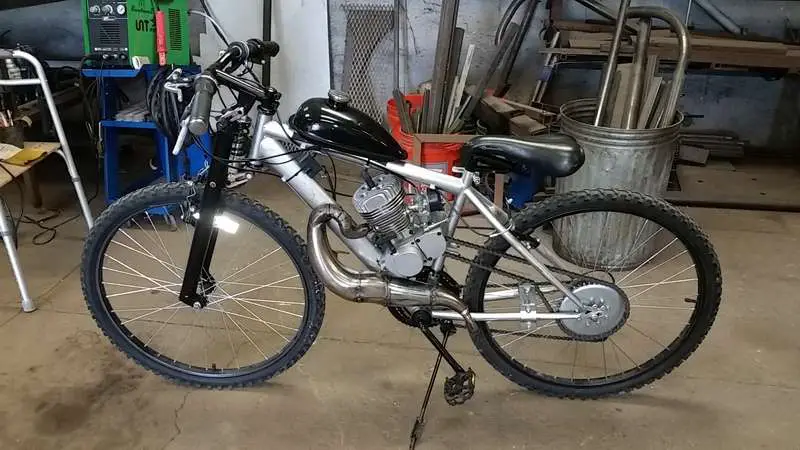

After breaking in my little china girl, I decided to begin experimenting with different exhaust in hopes of getting a little more speed.
I started with a Garmin GPS speedometer so that any and all changes could be recorded. Its a very handy tool for this type of work, and I highly recommend getting one. Trying to calculate changes without one is a waste of time! Without a speedometer, it seemed like louder equates to faster, which is not true!
So here is the bike Im working with prior to the experimentation....

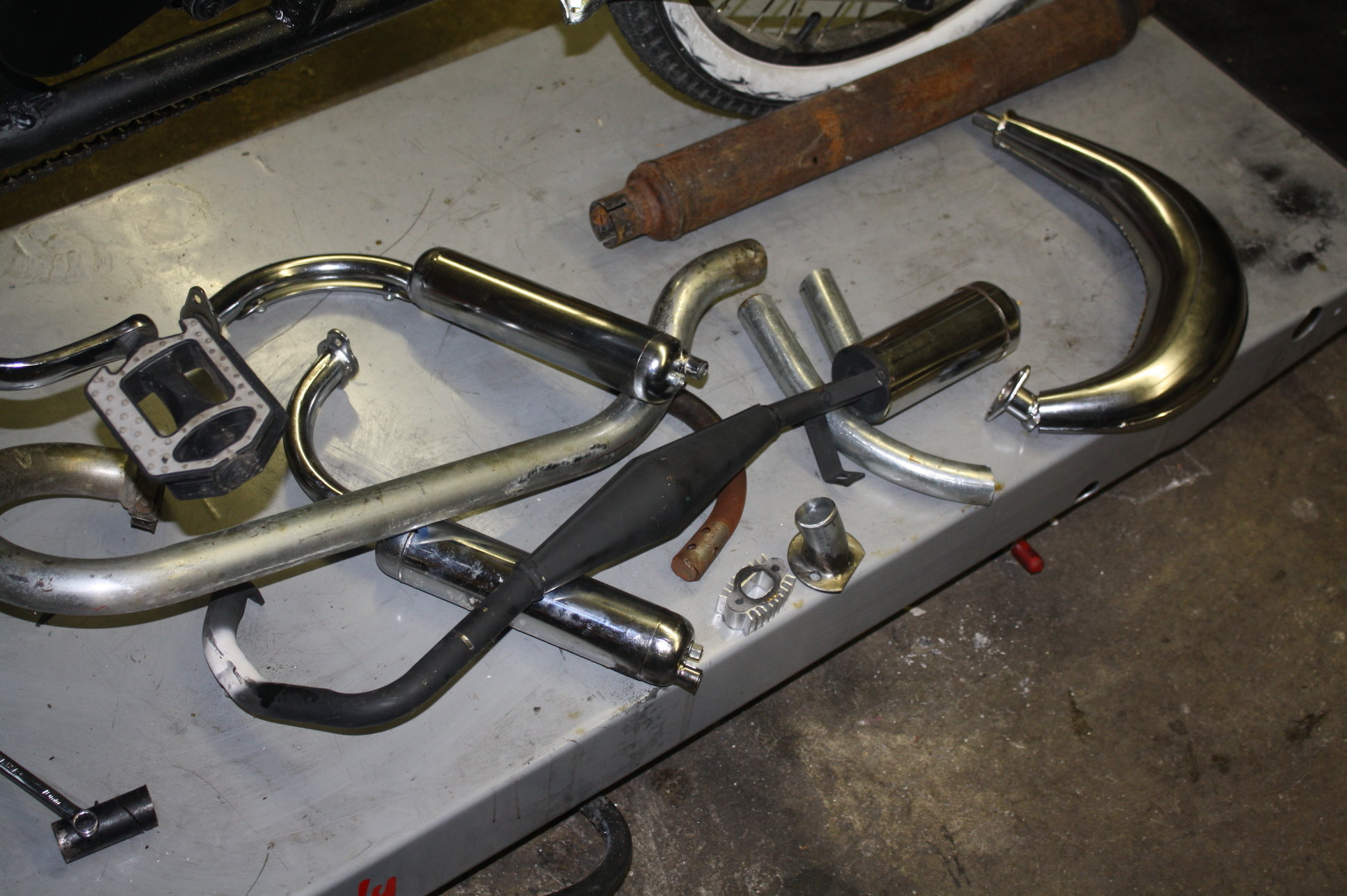

The first thing I changed was the stock muffler end cap. I drilled 3 holes in the end, like so many do. Sounded louder, but very little increase in speed.
Then I removed the end cap and baffle all together....Very loud, and actually lost a little speed.
I thought the bannana chamber (fat cat) would surely be the ticket! I liked its design where as it had a short header length, and increased in diameter right from the beginning. I installed it without any modifications. I saw an increase of aprox 1 mph. I was surprised as to how quiet it was. I was expectiong a loud ring-ding sound, but it didn't happed. I concluded that this chamber must have a baffle inside. So I removed the chamber and cut it open....It not only had 1 baffle, it has 3 baffles!

Not only does it have 3 baffles, but the intake was too small and I felt it could be improved. So I fabricated a new and larger opening....

This improved top speed by another 1 mph aprox. So I fabricated a longer and larger diameter stinger on the tail and re-installed...
I increased top speed by 10% by going from a modified stock muffler to a custom chamber.

Very nice work. I'm interested in changing my exhaust too. I see your chain is rubbing the rear tire just like mine did. Keep an eye on that. I have a trail tech speedo that works good, I also use a speedo app to confirm my speedo is right.
Mota- Yes , the new chain is still stretching. The stretching is slowing down, but still stretching!

The Fat Cat or Bananna is quiet as is, in stock form.
Removing the 3 baffles increased noise, but decreased top speed.
The intake didn't match up well with the cylinder.
The stinger diameter was very small.
I fabricated a better intake and larger diameter stinger. I also increased the length of the stinger.
Its now a little louder that it was originally, but still a lot quieter than I expected.
I thought it would be my best option for a top speed pipe, but it isn't!
