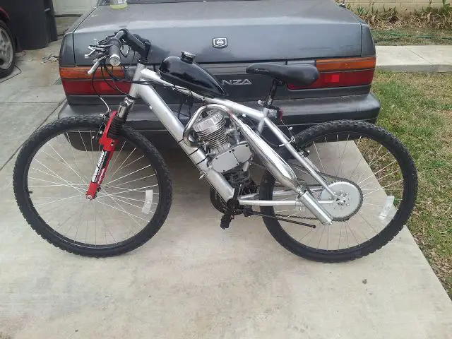

So I been thinking... every single expansion pipe I ever see for any 2 stroke bike has a relatively short length. Even though I "calculated" mine out to be 36 (ish) inches from piston to baffle cone, I gave it extra length to set the power band lower, but it seems that my "power band" never hits. I run an SBP pipe, and maybe its the flex pipe (more than likely, leaky, rough internals...) but I never feel the boost until I hit around 7000 RPM. Pipe is tuned for 8000 IIRC. But every single expansion pipe I've ever seen, for these bikes or even GP/street performance, isn't nearly this long. are my calculations way off?
