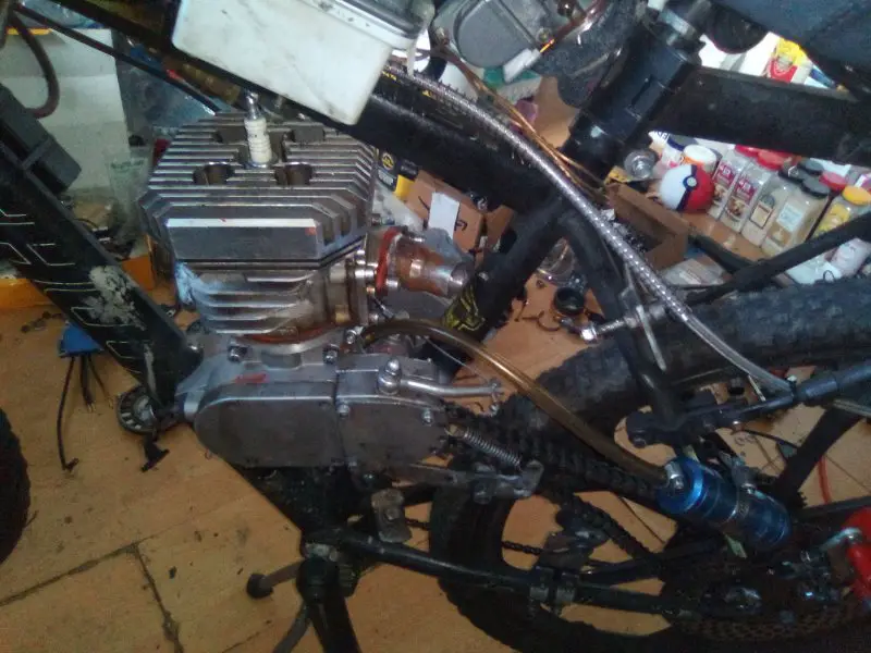

How is your bike set up for climbing, Testname, in terms of engine and gearing, etc?
watch my athena bike videos
and to me a piston with a little extra force to go up hills (47mm piston)
36tooth drive gear (back tire gear)
and a 420H motorcycle chain to carry the weight of me...
hydraulic brakes better safty
ceramic crank bearings... long life
BBR Magneto and BBR high performance CDI (reliable starting)
hmmmmm
boost bottle/expansion chamber on the crank case.... slighly better low end tourk/climbing power and idel smothed out......

I would test different sprockets. A 48 or 50 would be typical of an off-road setup. Chain clearance is problematic with oversized rear sprockets. A 44 would be a compromise. The one you choose partly depends on the size of your drive sprocket and the amount of help your engine needs to get you up the hill.
