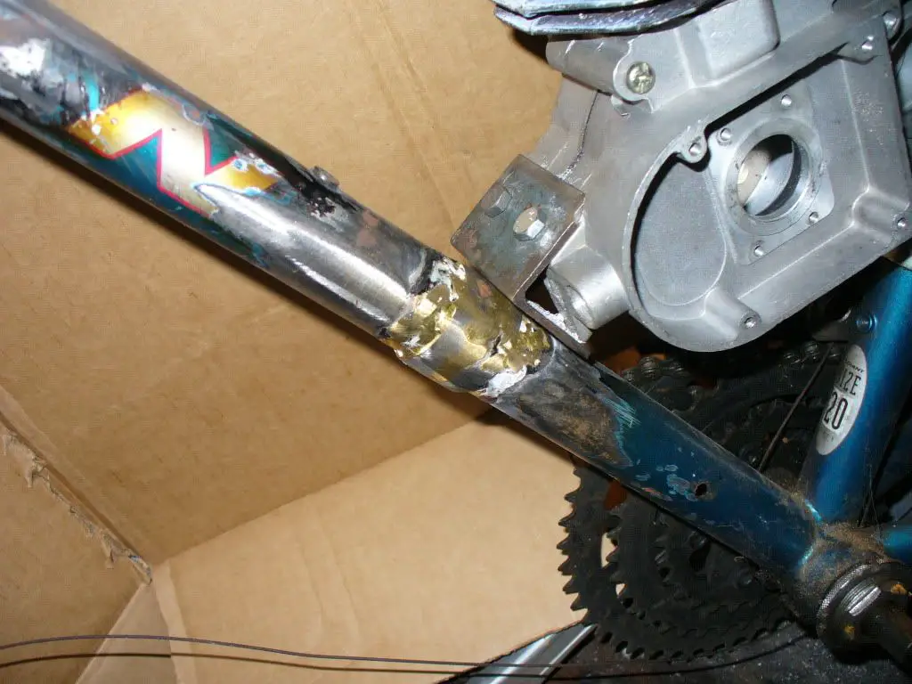

i've done it a few times for locals who wanted help putting there bikes together on the cheap, what i do is drill the hole over size, then insert a piece of tubing with 3/8 ID through the hole you drill, weld it in place and then put a 3/8 bolt through to the adaptor that come in the kit. the through tubing welded in stops from crushing the frame. i don't do it for myself but haven't had a problem with the ones i've done for others.
That is the only safe way to drill thrpugh the frame. My Giant sitletto chopper is the same way. Giant the manufacturer did the exact same thing for when they have to drill through the frame. There are about 5 places where they drilled throught the frame and welded the tube in the hole. Bike have never broken on those spots.
