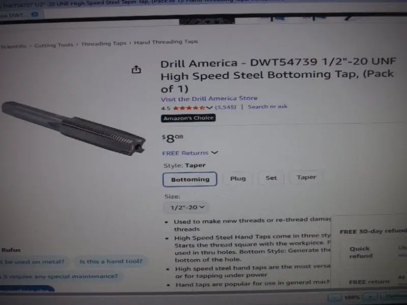

To repair 6mm threads use a 1/4" x 20 tpi tap - blind tap for blind holes Cost $4 -$8 AMAZON
Who knows maybe the poor boy has a 1/4" x 20 tap in his tool box
1/4" x 20 is the next bolt size up It's so close you won't even have to drill out the hole first
1/4" x 20 threads are more course than 6 mm x 1.0 mm threads and less likely to pull out again

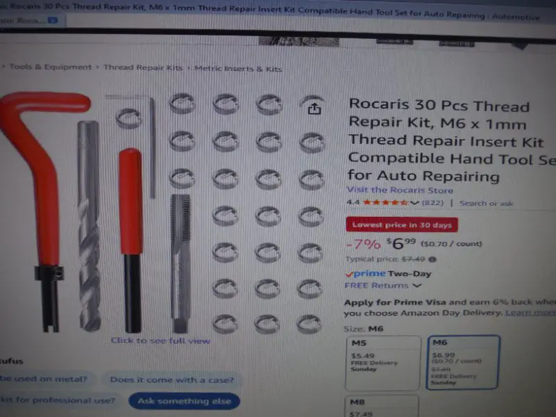

This is the common fix for pulled (stripped) 6mm threads in aluminum motorcycle cases
If the 1/4" x 20 threads pull out then it's time to install a 6mm Heli Coil

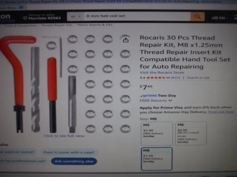

6mm Heli Coil Kit $7 on AMAZON and ya get 25 coils

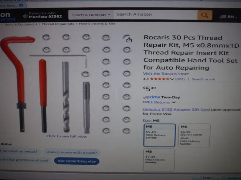

To repair 5mm threads buy the $6 Heli Coil kit on AMAZON and ya get 25 coils
To repair 8mm threads buy the $8 Heli Kit on AMAZON and ya get 25 coils

Now ya got the stuff to fix it right , Believe me you'll be happy you did it right the first time
