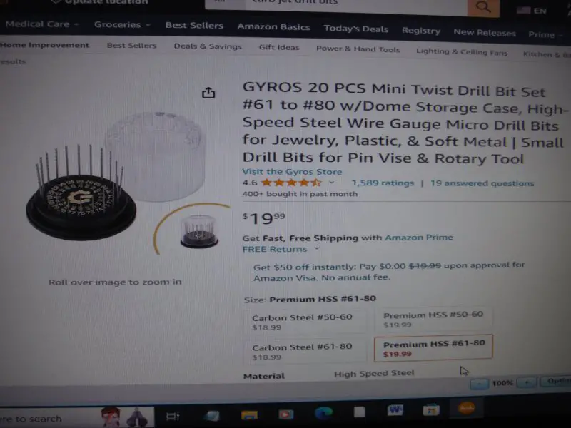

A strand off a brake cable will also clean the jet
But when it comes to changing the hole size in a jet, It's best to use a micro jet drill bit set
The jet hole can also be soldered closed and drilled any jet size ya want with a micro jet drill bit set
Micro drill bits, no guessing involved ya know what size jet ya got
So very true.............Curt
