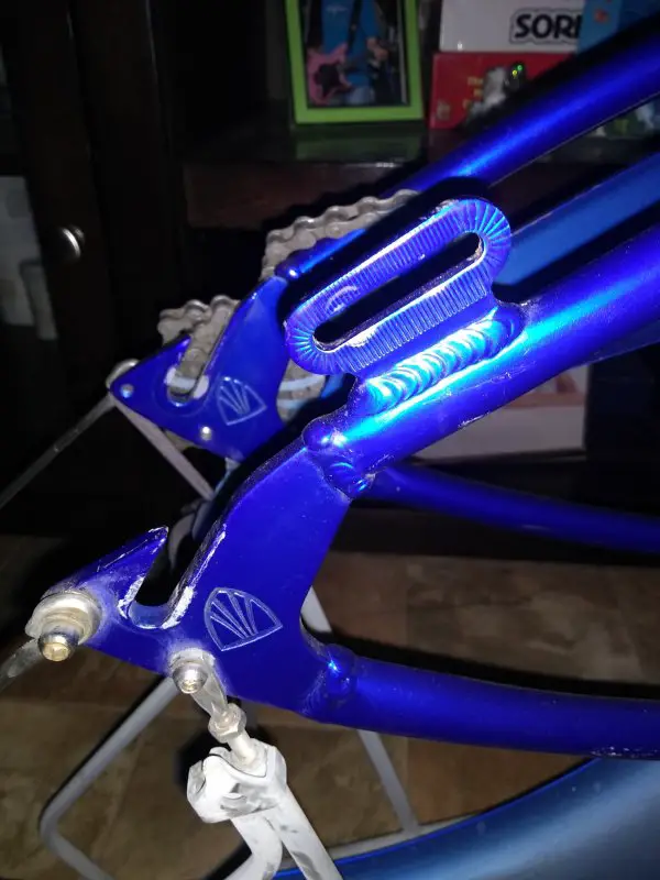

P Philingroovie New Member Sep 30, 2019 #1 Will I be able to install disc brakes with this rear setup or will I need disc brake caliper brackets Attachments IMG_20190930_000023359.jpg 73.4 KB · Views: 267

bairdco a guy who makes cool bikes Oct 12, 2019 #3 No. That's a coaster brake bracket. You'll need to weld on a bracket for the disc caliper, unless they make some kinda bolt on bracket I'm not aware of.
