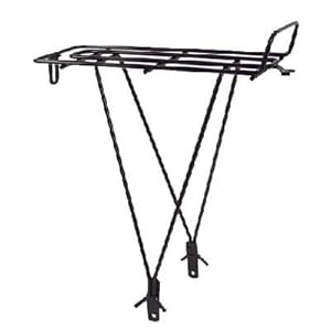

Wald Steel rack This rack is strong, and the tank can be mounted on top. You could cover it with some panniers or a fabric cover. You might even be able to paint it flat black with Krylon special purpose.
$10-15
http://ecx.images-amazon.com/images/I/31x3DIFU5oL._AA300_.jpg
