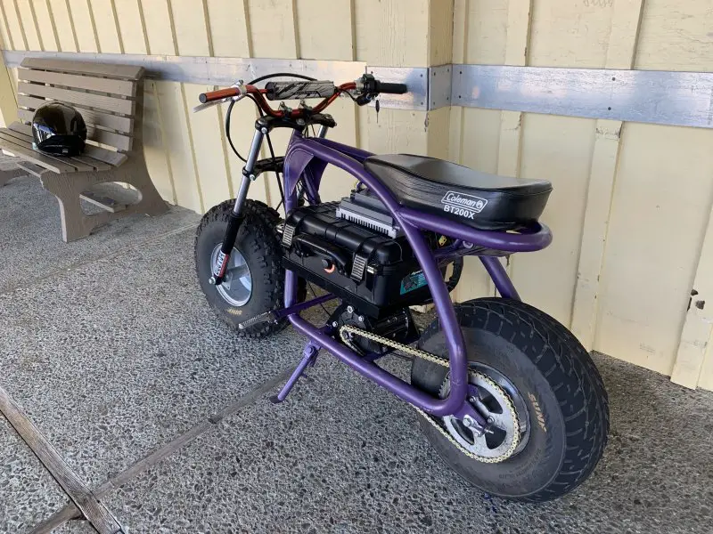

Just built this for a guy.. I call it the Tow Truck!! Towed my buddy 10 miles... 700lb total and still accelerate uphill

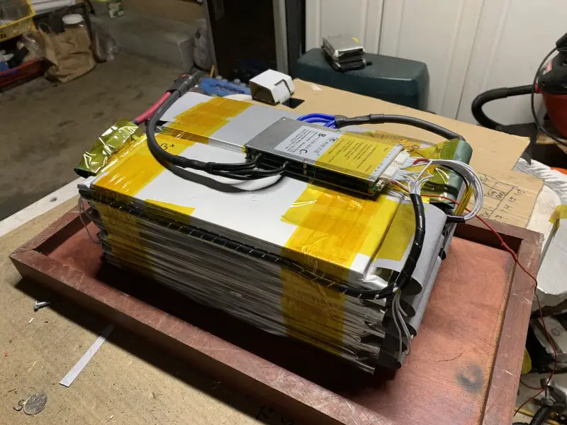

Custom Tony battery 72v 48ah
Qs138-70h with em150
Motor mounts are slotted to adjust for chainline side to side
8500 watts
Tops out 55+.. will wheelie off the line if you forget how quick it is for a moment!
8500 watts
