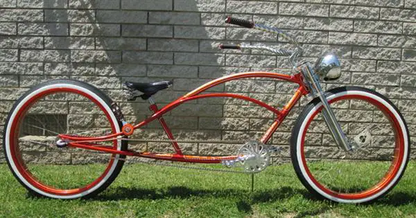

I'm assuming this is the kit you're referring to.
Well the reason I ask is street use requires differences vs off road use for example.
Just like recreational use requires differences vs primary transportation use.
For that kit I'd go more with a stretch frame cruiser.

That’s a very long bike! Can’t even imagine how to set a mount on that frame! Nice tho’ Yes , the motor mount is not quite that long
That's what this forum is all about figuring out how to mod things to make what you have work. It's much easier to fill in space than it is to create space.
A very big advantage of a stretch frame is when stopped you can put both feet on the ground; helpful when using a heavy engine. Yet while riding your legs don't have to stay at nearly a right angle bend; they can be at a comfortable length.

Yes, the pedal crank would be clear as well.
Those stretch bikes can be 900 bucks tho’
