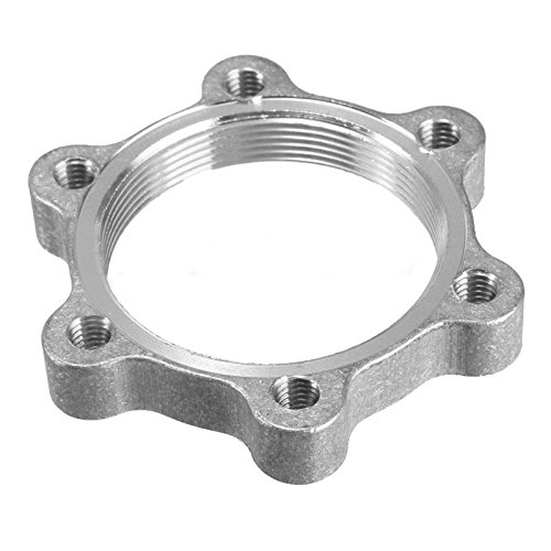

And FYI, you don't need to get new a fork or rim to have disc brakes. Just get this: https://www.amazon.com/dp/B01JRD9SZS
They also make one for the rear: https://www.amazon.com/dp/B01JR5U7K6
The adapter to make your front rim work with disc brakes is less than $3. The adapter to use rear disc brakes with your drive sprocket costs like $25. So for like $35 you can prep your bike for disc brakes. Then it's just a matter of how much you want to spend on the actual brakes themselves.

I want to go with the disc on the front. I'm aware of those adapters for the forks. To get a disc on the front, I'll also need a wheel with a disc adaptor for the wheel. The economy idea is to get a regular rear wheel, remove the sprocket, flip right/left, mount an adapter, mount a disc, and use the fork adapter with a regular disc brake mechanism.
I'll have to find a good rear wheel to use for the operation. Otherwise, maybe I can use a new front wheel made for disc brakes.
