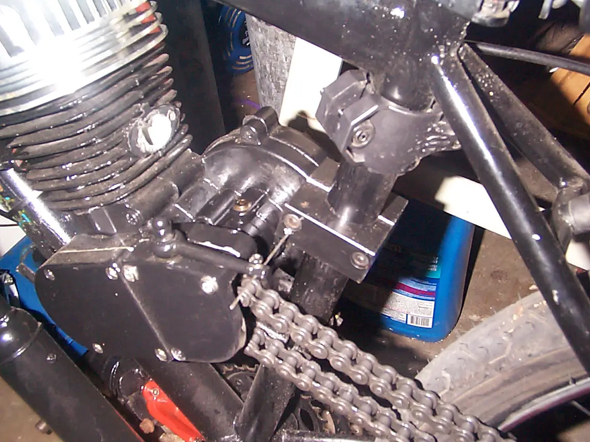

Whoever designed these engines put the clutch cable in the worst position. The cable holder is at the wrong angle and the cableen you install a different manifold.
I made a simple "clamshell" bracket to move the cable over. Nowits a direct pull on the clutch lever.

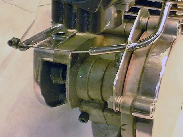

Heres an idea that seems to work for me. No moving parts and it's simple.
