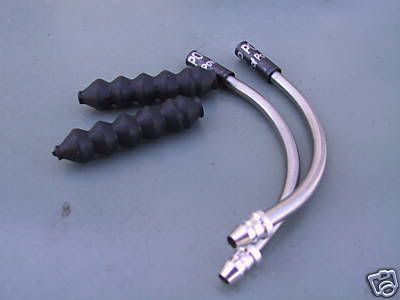

Know how your clutch is tight, how that ugly spring is well ugly and does nothing but keep the cable from heating up on the jug. Try this mod and youll be surprised when you feel the difference it makes. Best part is how cheap and effective it is.
V-brake cable housings.....
You can find them here.... Mountain Bike V Brake Cable Housing Noodles New - eBay (item 230332851537 end time Apr-21-09 18:14:19 PDT)
How it looks when installed.....
This is a great mod, your clutch will feel easier to pull, the spring will be eliminated and it allows you to run your cable in from the top of the frame without putting a stressful bend in the line.
