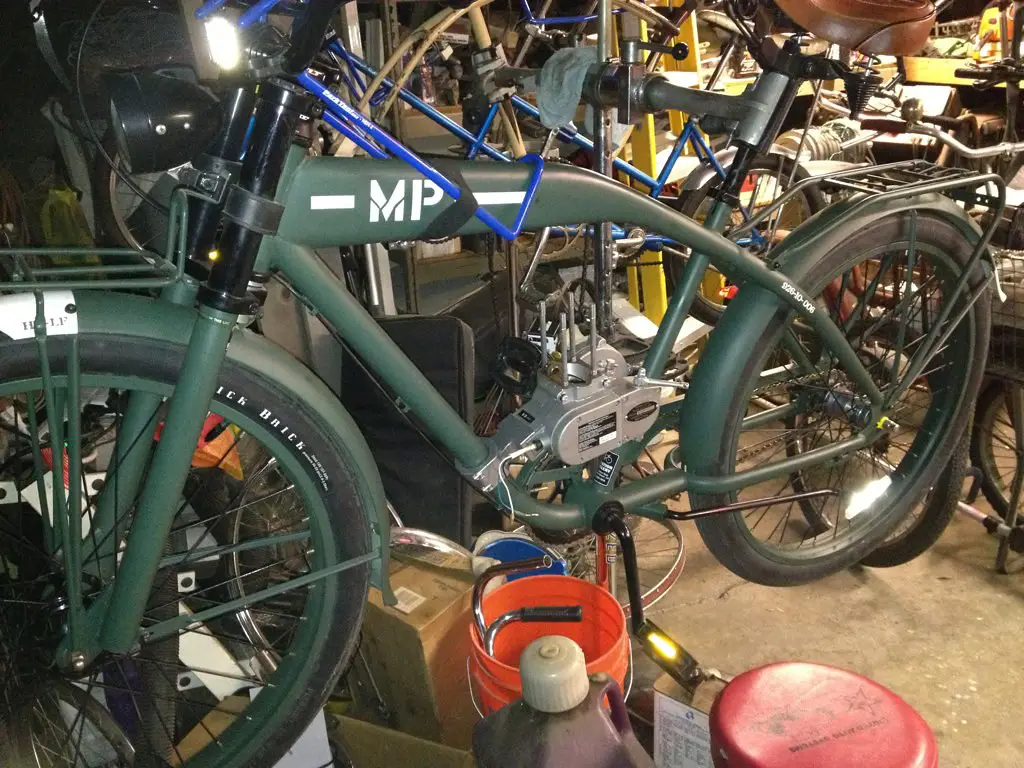

You got one of the new style Felt MP's, do you have a pic?

Felt MP by dragboatdamon, on Flickr
I bought it on eBay for just over $400 used. I haven't selected or built a tank yet. When I'm happy with everything else that will be the last thing I'll try to do. I'll be at the Cycle meet at Vet's stadium this Sunday, probably riding my Whizzer. If the stars line up and the gods are favorable I might have the MP done, but I'm not going to hold my breath.
