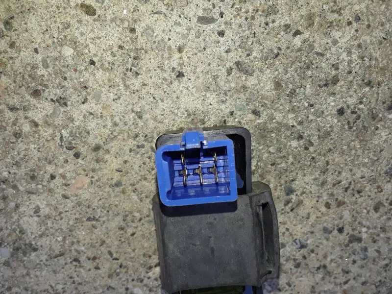

I have a 1999 Whizzer Pace Maker 2. It's got the WC-1 motor and I am in need of a CDI or if there's a different one I can order.

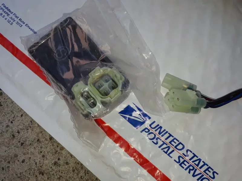

Im only using the simple harness just so it will run. I got one of them new ones it came with a harness that was all cut up. But it has a two plug and my harness is just a single plug.
I really do appreciate any and all advice. Thanks

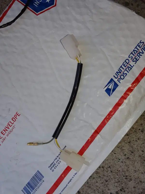

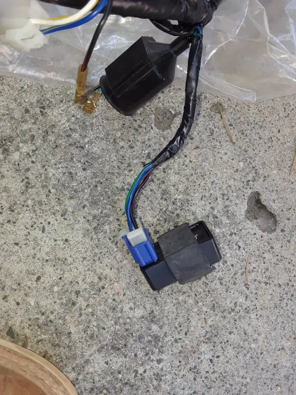

Whizzer Paul will have the 5 pin cdi go on his website. The new harness is different from the old harness. You have to change the cdi and stator plug with a adapter if you use the new harness. I'd stay with the one.
First pics is old harness, second pic new harness
