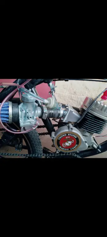

Just attached this keihin carb. Is decent up to half throttle, revs a bit high but that's fine I guess. But from half throttle to full it's like totally unresponsive. barely hit 30 mph. Im sure I have to reset but I was also told that I wouldnt be able to with this build. "That carb is way too much for that build, you will never get it tuned right! You would have to spin that motor at 13,500 rpm’s just to think about using that much fuel! Too much volume not enough air speed! 18mm carb will supply the hottest China doll with fuel!" Is that true? I don't wanna buy another carb if I can tune this one. Help is appreciated. Btw, i already fixed the head so u don't gotta worry.
