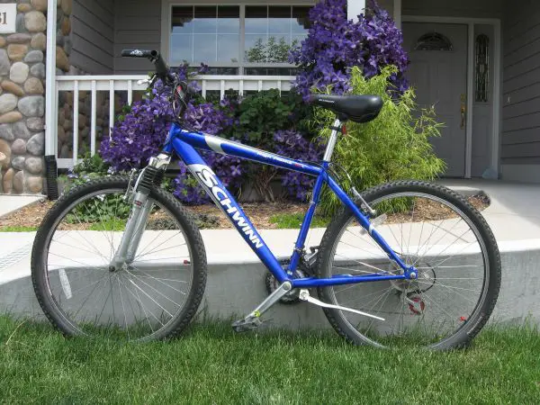

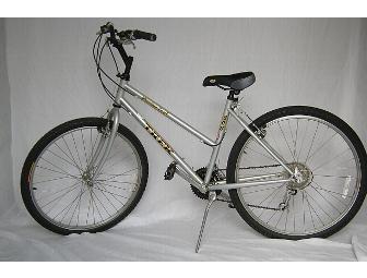

Which bike do you suggest is a better bike for a project like this?
schwinn high plains 3.6 fs
Trek mountain track 800

It would depend on what kind of motor you plan on using. Neither one of those bikes is great for a china girl, but you can make do with the Schwinn.

the tubing on both of those is a challenge for in-frame installs, one is too large of a diameter and one has poor placement. Of the two presented, id pick the Schwinn. it has front suspension, that's important.
with the schwinn, he could use a universal motor mount (the u-bolt style, not the one where you drill a hole in the frame. with the trek, looks like just abour his only options are fd or some type of chain driven rack mount.
