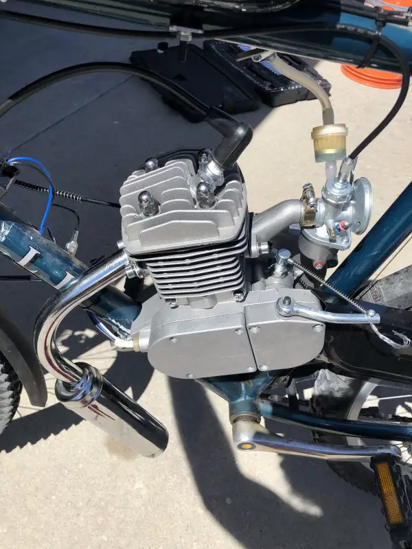

I've included some pictures and a vid of me trying to get it running (sorry in advance for the bad angle)

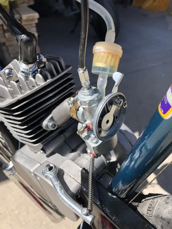

Yes I am running no air filter atm, just makes it easier to tinker and replace the carb. The problem was still the same with the filter.

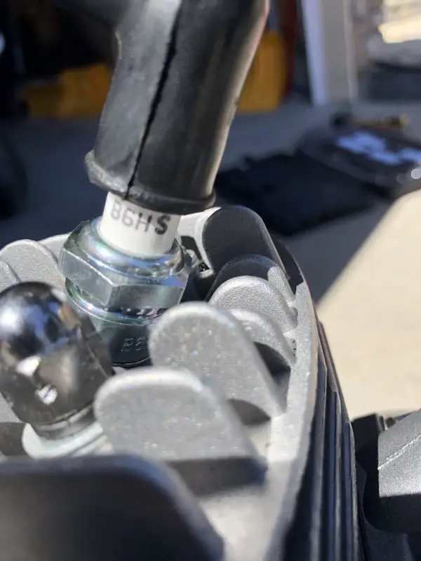

I have compresion and spark (switched from stock plug to NGK) and my NT carb seems to be working.
I am using a ExGizmo 80cc engine kit from Amazon (no manual included lol), but it seems to be a dime a dozen china engine.
Hence, idk what to do lol. Any ideas?

In the pics the Choke is still open some. Try closing it all the way until the engine starts for 10 to 20 seconds then open the choke all the way
Possibly
Not enough fuel - Check the float height,
Check S/P gap, - Too small
Faulty kill switch slightly grounding out - Disconnect
Check for compression leak - Feel for air around Cyl head
Possibly
Float and SP are in the correct placement, just measured
I disconnected kill switch, no change
Trying to kickstart and feeling for air, I didn't feel anything
I would try what @wrench suggested.
Try replacing/cleaning out the carburetor.
I'm probably just gonna buy a new carb off amazon any suggestions?
