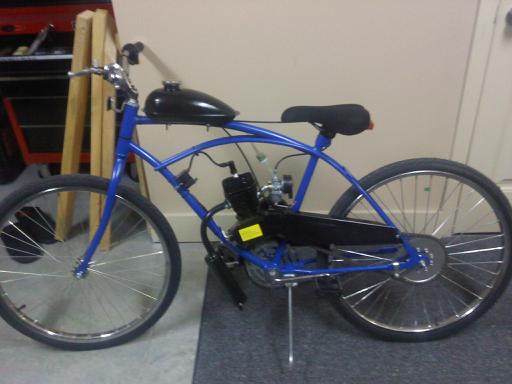

Well here she is, all finished up and ready to leave the nest. I hope she sells soon so I can buy more stuff and build another one. This one rides like a dream, very smooth and lots of pick up right off the bat.

Thanks 26, Just took her for another test drive and I can't get over how good this bike rolls out. Nice and smooth and getting faster by the minute. Whoever buys it will have a good bike, not too flashy, but I like to keep it simple.
