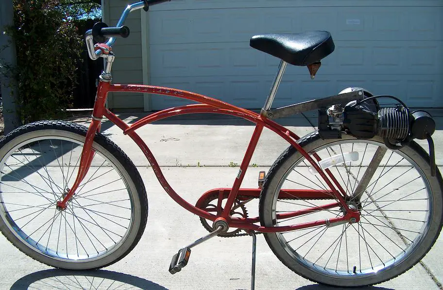

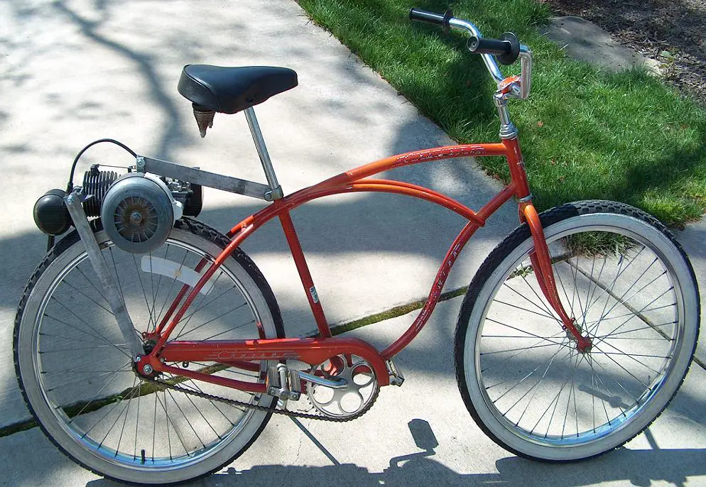

Been watching other builds while I am accumulating parts and knowledge for my other build.
In the process picked up a AMF Roadmaster moped engine off Ebay for $30.00 and wanted to play with it. It's a 2 stroke 49cc and is made by McCulloch (BHE 900) in the late 70's. Has two magnetos and a alternator to generate electricity for a headlight, horn, stop lamp and tail lamp on the original moped. Engine also has a compression release valve.
Put on a new ignition system, spark plug, carburetor, carburetor return spring and stator. Wasn't getting spark by turning the flywheel with my cordless drill, so it was suggested to mount the engine and pedal the bike to check for spark. That's where I am at this point. The mounting system is preliminary. I plan on using a scissor lift system on both mounts. Metal was what I had lying around.
The bike is a 80's Schwinn that I bought several years ago for $40 and had in storage. I know the knobby tires are not ideal for a friction drive, but that's what was on the bike - the still hold air after all this time! I'll definitely upgrade the tires.

Still a work-in-progress. Need a fuel tank, clutch level for lift system, and throttle.

Nice engine find! Were you able to get spark after mounting it? There's a lot of old hands around that can help you with an older engine. :)
Bikeberry, Pistonbikes, Dax, or Gasbike can help you with the miscellaneous parts you need. See which one is closest to you, to save on shipping.
I say run those tires 'til the roller eats the tube, then worry about a new set. :p What's the diameter of your roller btw?

able to produce spark - got a nice jolt holding the plug as I spun the bike in circles in my driveway!
I don't know the size of the roller since it was factory installed. It looks like a pain to remove, according to the factory service manual. I'll just glue a new piece of sandpaper to the roller if I have too.
Per a video on You Tube, the original AMF Roadmaster moped goes about 20mph - it's a putt-putt type.

if you can, shorten the mount to tuck the engine as close to the seat post as you can without it getting in your legs and foots way, it will be alot stronger and i think would look better
paint the steel red like the rest of the bike and leave the motor in its old lgory
