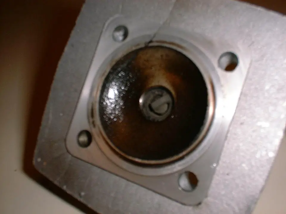

2. Does this blown head cover show signs of running lean from an air leak?
That might assist in keeping the cap from loosening , and that would be a something to consider . As for sealing it because it is letting air in even when it is secure , that sounds like overkill . That head shows signs to me of being rich . Is the head itself ruined for some reason or just the gasket ?

2.No, that cracked head is from something else.

The head cracked when I heard a loud pop bang. I ask about lean running because it has a lighter looking area where I guess the flame was hottest. It experienced runaway idle a few times which I thought was an air leak and I couldnt find it by spraying, but when I removed it the bottom of the case was weepy. It smelled like burning rubber when it first ran.
