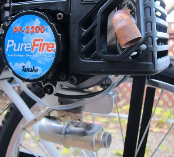

I have added a little 3 HP Briggs muffler to my happy time with good effect and am now doing the same thing on my Tanaka 33
http://motorbicycling.com/showthread.php?t=34834&highlight=The+Silencer
Proven to work.

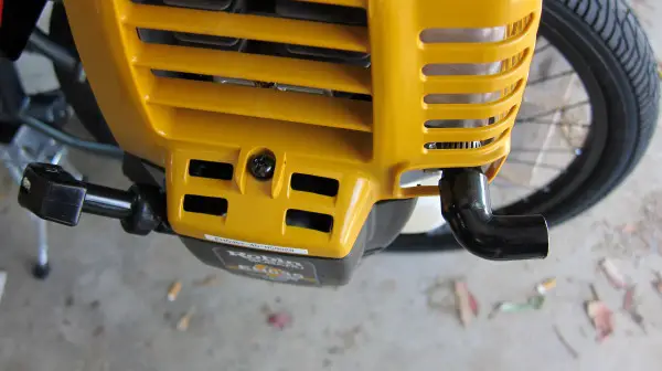

Almost forgot, I added an elbow to my Robin 35 just to angle the noise back. So it is pretty easy to attach half inch standard plumbing fittings and go from there.

I would braze it. You can get low temp phosphor bronze rod at the hardware store and this will braze copper to steel. Yes, braze it right to your stock muffler and run both mufflers. Yes the happy time is a 2 stroke, but mufflers don't care they just reduce noise.

I wouldn't worry about it. It's not like you are going to braze up the boiler in your house.
Not like CO gas is going to leak into your enclosed car.
Not even providing structural support of any substance, just attaching copper to steel and melts higher than exhaust gas temp so the joint won't melt like if you soldered it.
If you want the really good stuff (very low melting point ~1500F) you need to go internet.
The problem here is copper melts at 1950F and the high strength brazing alloys are up around 1800. Which doesn't give you much room between when the metal is hot enough to braze and when the fittings melt.
It seems I was incorrect though, the rod I bought at the hardware store was this;
http://www.amazon.com/Bernzomatic-N...g-Welding/dp/B0000CBJGM/ref=pd_bxgy_hi_text_y
This melts at 1680, so you have about 300 degrees of comfort zone. The copper will have to be cherry red to melt the rod at about orange color it melts. The steel you don't have to worry about.
