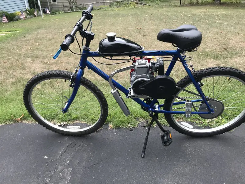

I have similar issue. Brand new 4 stroke engine....ran great for a few days....then suddenly won’t stay started, and giving it gas has NO effect. I though it was the carb....or possibly broken flywheel. No...the problem is this new “upgraded” gas tank they put in my kit. It has the threads externally, rather than inside. So now on the petcock valve there is a bolt that affixes the spout rather than the spout being physically screwed into the tank. PLEASE keep in mind how difficult it is to not make jokes when using words like petcock and screw.
Anyway.... I found that my valve was crap, and the externally attached bolt had separated from the tube that goes into the gas tank.
There was literally just a drip of gas at most making it down into the line. The petcock SUCKS....another missed joke....but essentially the valve is garbage. I had to order another one on EBay for $8.00.
So although it looked like it was getting gas...it was not. And YES I had the valve open.
So check your fuel valve, and check your fuel filter. Those can SUCK too.
