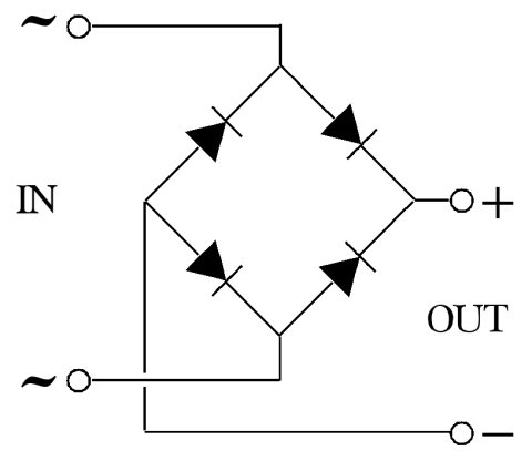

Would this work as an AC to DC circuit? I'm aware the DC current would be ridiculously rippled but that can be fixed with caps I'd imagine. If this is basically the start point for the rectifier already listed on the forums, I apologize, I have trouble reading wiring diagrams.
attachment.php
EDIT: took a long hard look at the wiring diagram at the bottom of the first page on the DIY rectifier page, and noticed that what I have here, is a larger version of the bridge rectifier. Neat. while it makes this thread pointless, I have to say I understand it a little bit better now that I've figured out how to build the bridge rectifier outside of the IC (however the IC would obviously be much smaller)

12v mini gen? Are you talking about a Wonderful Creations 12v mini gen that produces 12 Volt A/C? So what you are looking at is designing a single phase rectifier?

yup, a 100uF cap as far as I could see in combination with a 100ohm resistor afterwards produces a relatively stable DC signal, vDroop is only around 0.02v . However I'm having trouble (perhaps I missed it on the ebay page?) finding how much amperage either of these mini gens is capable of producing.
EDIT: checking the site again, it says it produces 12v AC at 1300-1500 RPM (I think thats idle? they say its 15-18mph riding speed though). and "Over 18 volts and up to 1.5 amps at high speeds", or 27 watts (? I'm not sure if AC wattage is calculated the same as DC wattage) but that's essentially 18v @ 110hz (6600RPM) x 1.5a
EDIT2: how would I go about stabilizing the voltage to 12 volts output if the input can be anywhere between 12 and 18v? I'm thinking I'd need a MOSFET, however Wikipedia and a couple other sites show use of a 7812 IC I believe.

Remember the LM7812 is only good for 1amp, so you will need a way to regulate your voltage that will handle a higher amperage output. Luckily you can still use a LM7812 with and added transistor to create a high amp regulator.
