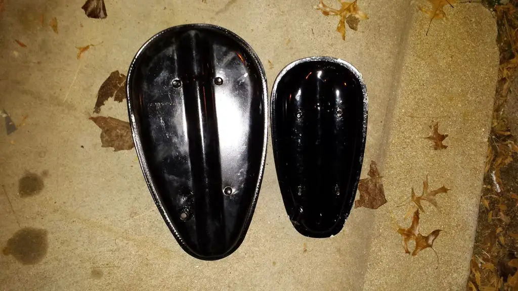

Does anyone have a picture of the 3.5 liter tank bike berry sells on a bike. I'm trying to visualize the size compared to the tank we get with the kit.

mine came in today. There is a little rust in it but I guess that is to be expected
it definitely is bigger than the other one.
new whizzer tanks are 4 liters (though I guess the older ones would be 3.7 liters - one us gallon)
It doesn't sit as low as a whizzer tank but there is a 70 dollar difference in tanks
that is a whizzer tank & if you pour water into it to measure, you'll be close to 2 gal
got 10 of the 3.5 tanks in last month and they (snuggly) fit in same box as 2.5 tanks
I'm not sure what I have then. I thought I ordered a 3.5.
If I got a 2 gallon, great. I'll take a little rust for the extra capacity

This is what the fat whizzer tank for the 2008 ambassador looks like....you'll notice the mounts on the ends.
The tank pictured isn't whizzer , it's just a fatter peanut tank.

That's what I thought. It's longer and bigger than the tank that I have ,more than a few times, described as "fugly".
