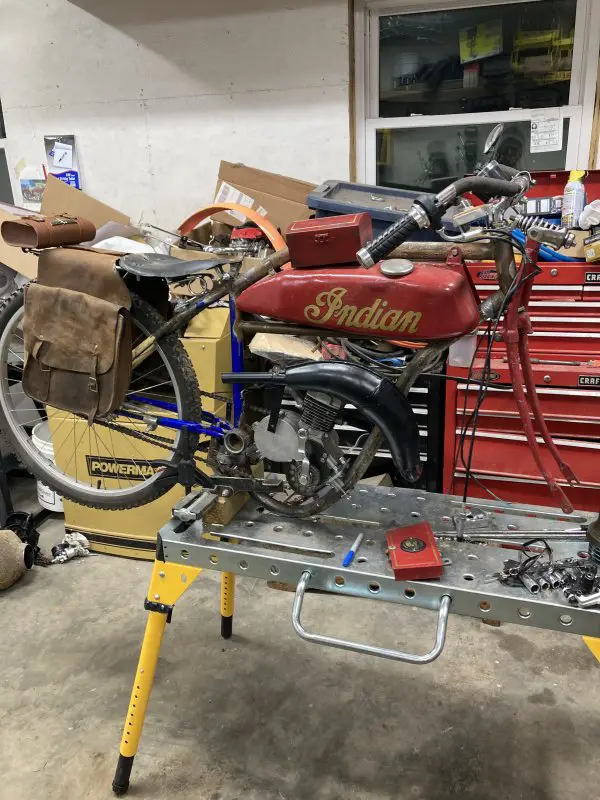

Hello, new member here. I need some advice on what to do for the exhaust on my 2 stroke bike.
It’s a replica/tribute 1920s Indian so I want something that will look vintage but also improve performance. The pipe I have on it just looks too modern.
What have you guys found or fabricated that looks and works good?

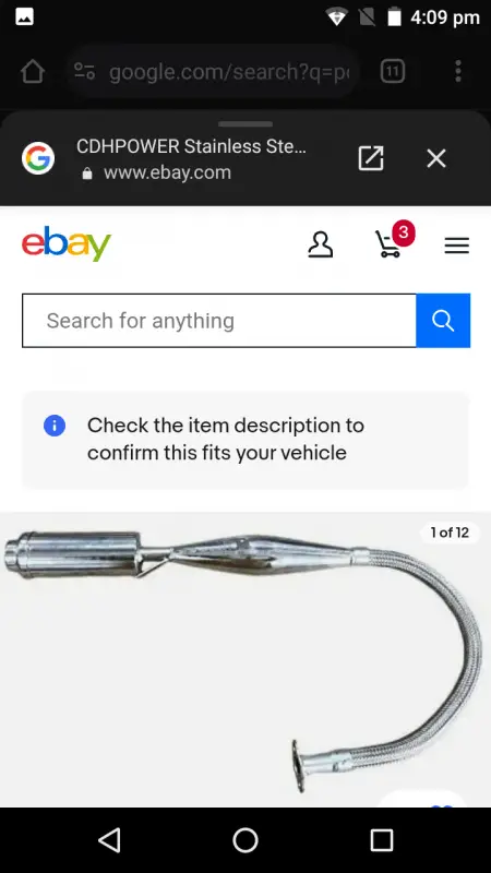

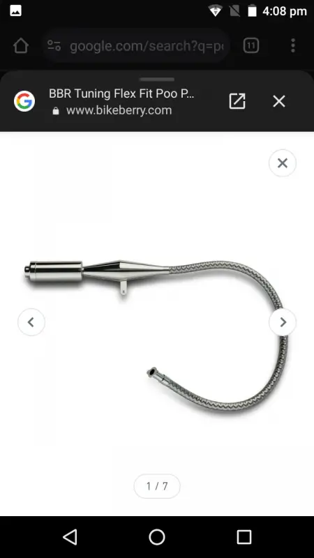

Check out a "poo poo flex pipe". It's "classic" style will fit in nicely AND it's got an expansion chamber and a muffler and definitely helps the bike run smoother, stronger and quieter... and very easy on the exhaust flange and of course very flexible.
I would try and stick with a brand name that is recognizable rather than a knock-off because as you can tell there's a difference in length in the exhaust flex and that difference can affect the tuning of the bike as there is a science to it all.
