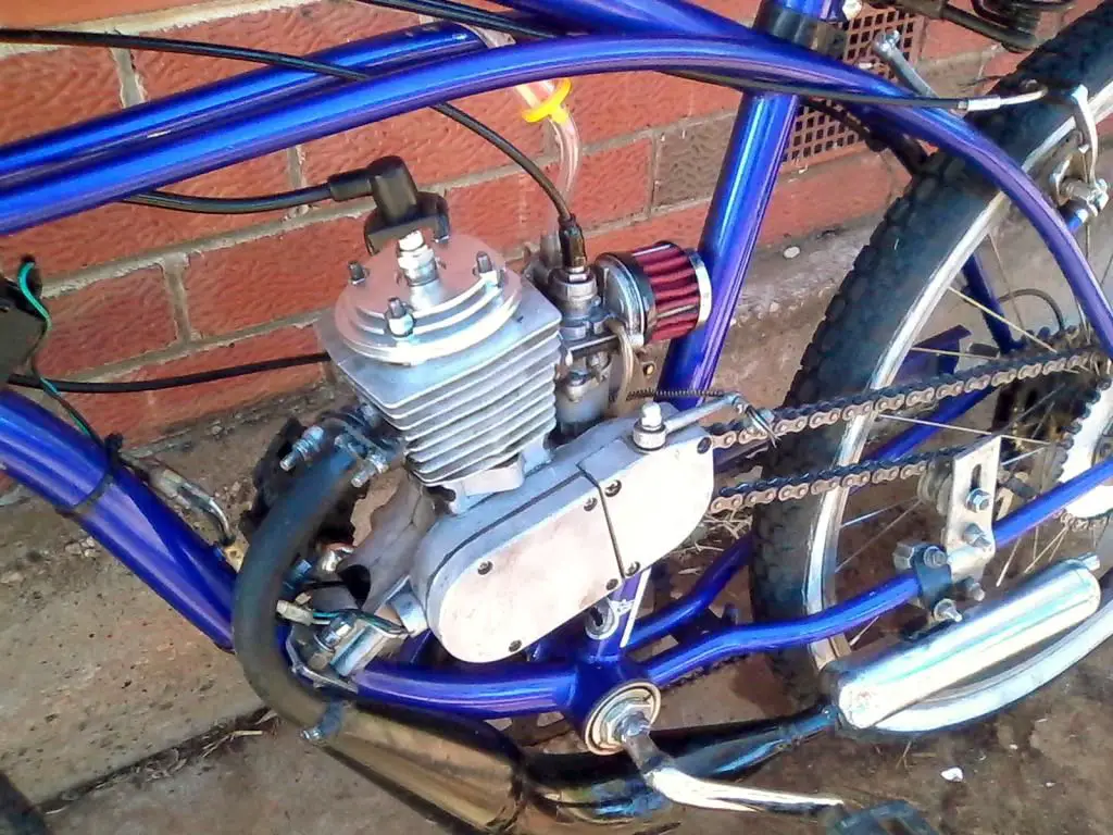

i have tried this on a few different 50cc kits and it works well.apart from the performance boost it reduces vibration and engine noise the only downside is there is less surface area for cooling but i havnt had any problems

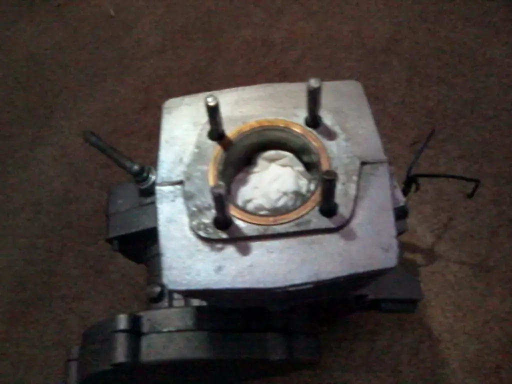

first i remove the bottom fin so the top piece can push down on the dome and gasket hard and elongate the holes to fit the 50cc stud spacing
![](/proxy.php?image=http%3A%2F%2Fi940.photobucket.com%2Falbums%2Fad241%2Fexacutioner%2FIMG_20130402_185103.jpg&hash=7728bec33ff2064f1f43eed412b7d3bc)

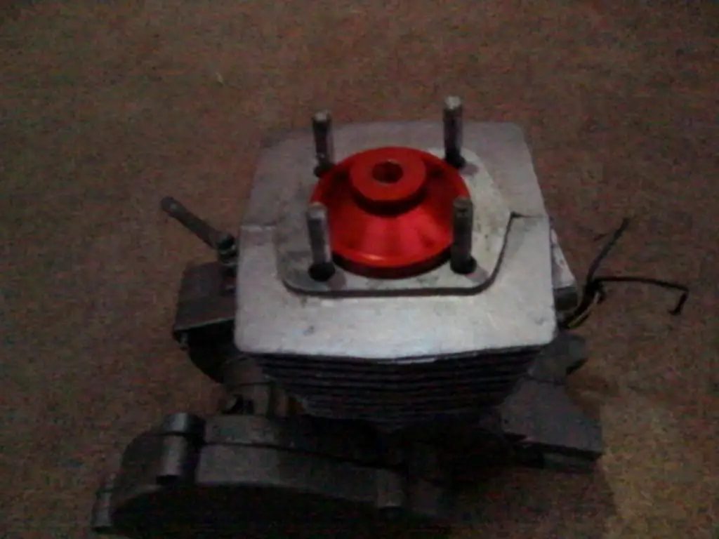

then fit the copper gasket and dome
![](/proxy.php?image=http%3A%2F%2Fi940.photobucket.com%2Falbums%2Fad241%2Fexacutioner%2FIMG_20130402_192329.jpg&hash=6f02cb9a5d7bcaa17cb6eb5d6903007f)
![](/proxy.php?image=http%3A%2F%2Fi940.photobucket.com%2Falbums%2Fad241%2Fexacutioner%2FIMG_20130402_192406.jpg&hash=6c7458c2c96ce84876f82c728e658cb0)

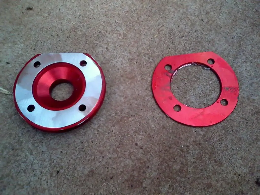

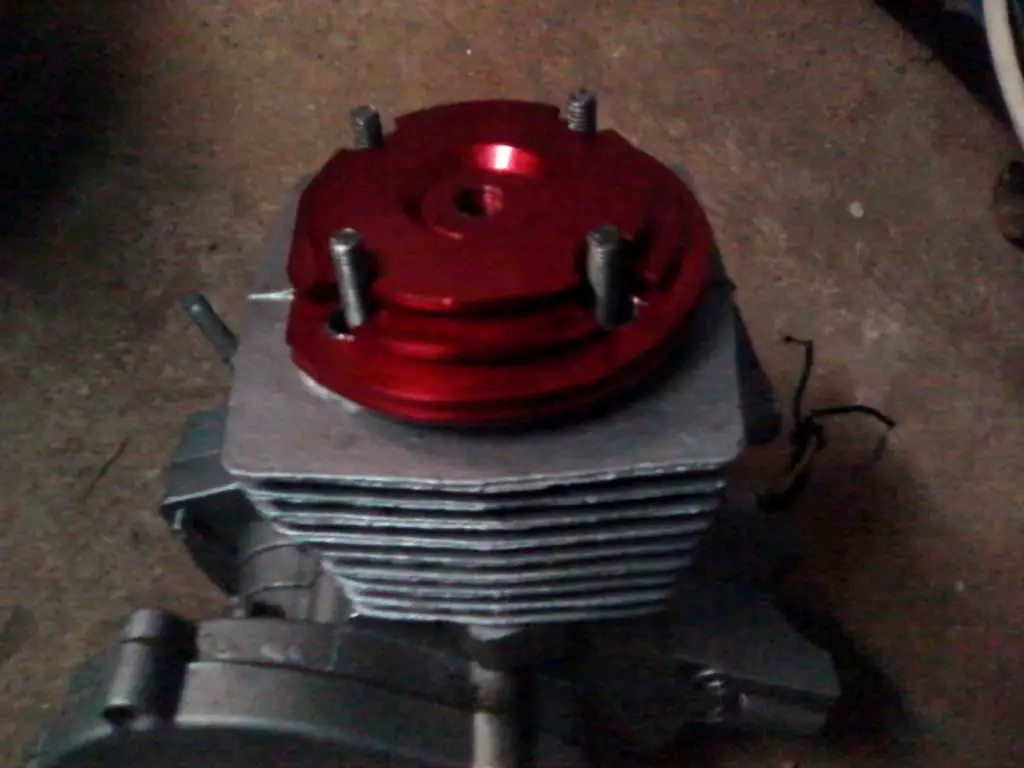

then the top piece
![](/proxy.php?image=http%3A%2F%2Fi940.photobucket.com%2Falbums%2Fad241%2Fexacutioner%2FIMG_20130402_192848.jpg&hash=98039eb91831c0b84e41db38c89c3ee6)

on my friends 50 we had to use 2 gaskets as the compression was too high and it was pinging
